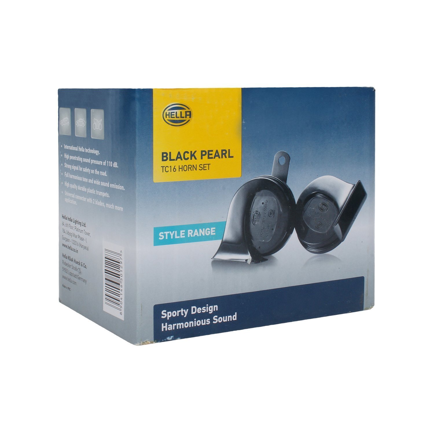

Can someone please advise me if Relay is necessary for Hella Pearl Trumpet Horn Set (picture)
I intend to replace Brio stock horn as it showing age and fails to serve purpose.
I have used them on my Punto and they didn't require a relay.
But I would suggest you to go for Hella Chrome trumpet. It's bit expensive than Black Pearl, but the difference is pretty remarkable. Also Black Pearl went kaput in a year and chrome is working fine for more than 2 years now.

Can someone please advise me if Relay is necessary for Hella Pearl Trumpet Horn Set (picture).
The thumb-rule is - If your car already has two-unit horn set, then you can directly replace them with the new 2-unit set. However if your car has a single unit, but you have got a dual unit type, then you need a relay.
Thanks much for your reply.
Brio top end comes with dual setup but mine isnt top end, does that mean (usually) they will have different ways of wiring for horns across variants ?
My car is out of warranty so I am not hell-bent to avoid relay though.

Brio top end comes with dual setup but mine isnt top end, does that mean (usually) they will have different ways of wiring for horns across variants ?.
I am not sure how the wiring is in the Brio, but adding a relay is a simple procedure. Check if the Honda ASS itself could it for you - or a good FNG.
Open and check the fuse box in the engine compartment. If there is a horn relay and fuse it will be marked on the lid. If you don't see one in either engine compartment or in-cabin fuse box then it is safe to assume that your vehicle doesn't have a horn relay or fuse.
If you do find a horn relay or fuse and you can go ahead and swap out the OE horns with something more powerful. Just keep the total draw within what the fuse is rated for.
If no relay or fuse, its wise to add one before upgrading horns with higher current requirement.
