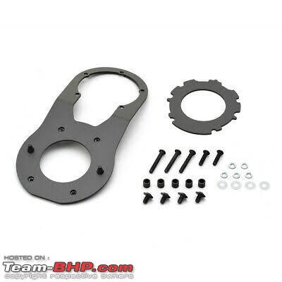

Here are some detailed pics of the ring kit and flange.

Will order for the flange and the ring kit this week. The flange is a universal part , it's the ring kit which is designed specific to each bike due to the tank ring holes being different on each bike. What they should do is provide a universal ring kit without any holes, so the holes can be locally drilled as per any bike.
Which brings me to another confusion. Which bike specific ring kit should i order. The holes on the Xpulse and the Tiger (BF02) are very much similar so i can take the risk and order it. The only problem is if the holes are too close , then they will overlap and be useless. The other option is i get a ring where the hole design is completely different - like the Suzuki kit where the holes are in a triangular pattern.
Anyways, that's for a later stage. My brother fitted the S430 Seatlock mechanism and it was a perfect fit. I haven't tried it with the bag, but will do so soon and update here.

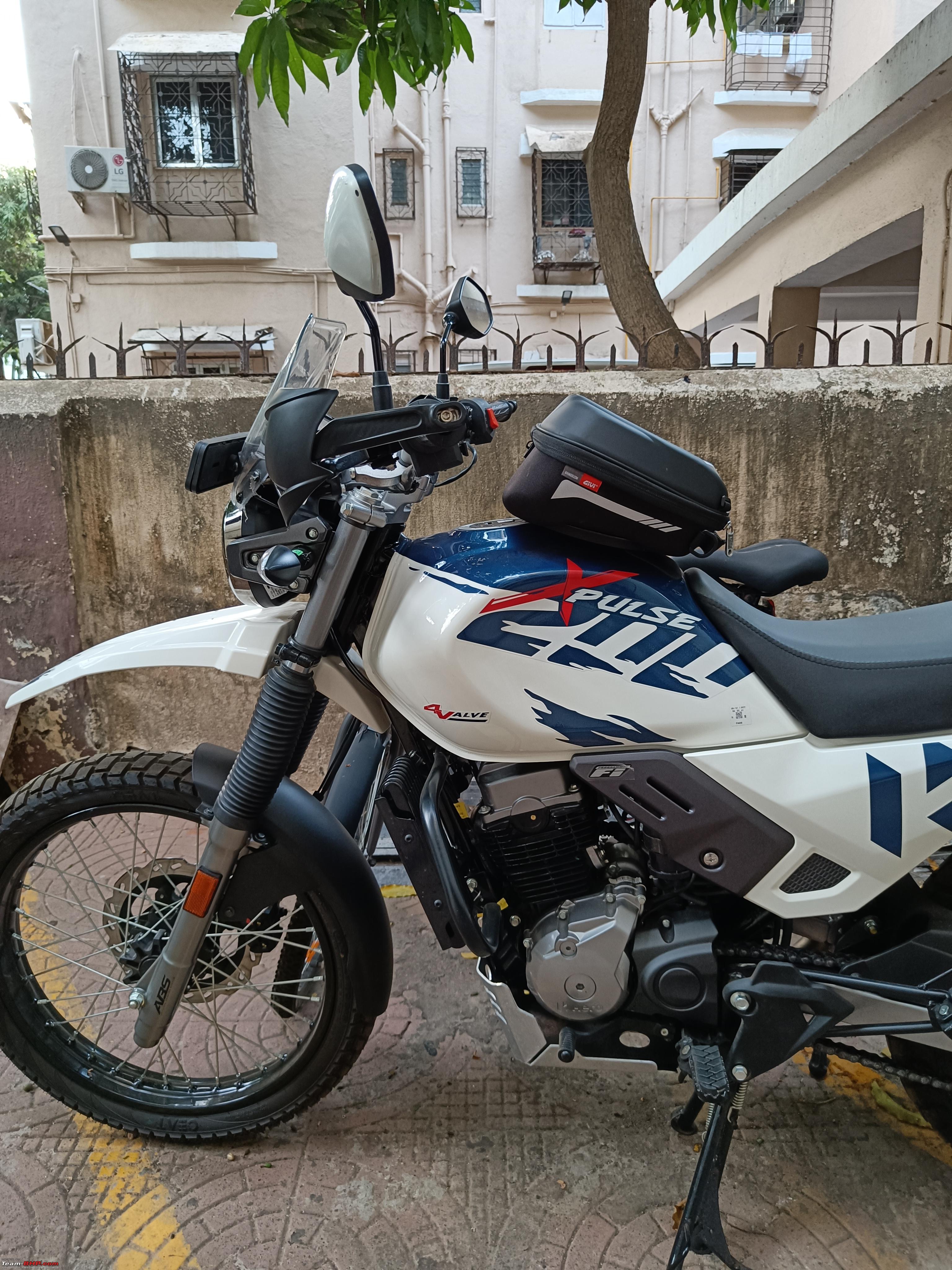

Sorry was out of town and could not update on my tank bag fitting onto the Xpulse.
So here are the various possible fitments for the Givi ST602 tank bag.
The bag placed on the top rack - will need to figure out a way to install the tanklock mechanism (ring and flange) on the top rack.
The bag placed on the pillion seat - for which i already have the Seatlock mechanism.
The bag placed on the fuelcap - notice how close it is to the handlebar.
There is no room for the handlebar to move with the bag placed on the fuelcap. So this option is totally out.
The bag placed slightly below and on the tank slope.
Notice how much space there is to now turn the handlebar.
