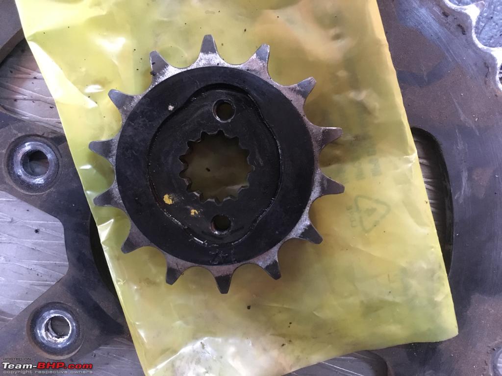

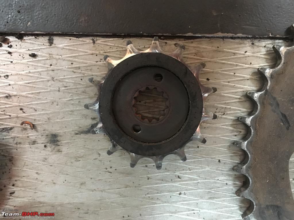

So I swapped the 15T front sprocket on my 2016 D390 today for the 14T unit from the D250. Also got a new chain and rear sprocket (stock D390) as it was due for replacement.
The installation was carried out by Mapusa KTM and was very straightforward. Initially they were a little hesitant as they haven't done it on any bike yet but after I pushed for it a little they agreed. I only rode a short distance (15-20kms) after it but have noticed stronger acceleration pulls right away! Haven't had a chance to take her to triple digit speeds and see if there is a significant loss in too speed.
Happy so far with the bike and will update once I take her out properly. Attaching a few pics.
Old 15T front sprocket that came stock on the D390-

New 14T front sprocket from D250-
The KTM Duke 390 Ownership Experience Thread-imageuploadedbyteambhp1543342433.232156.jpg

Originally Posted by shyn View Post
Any updates? Did you try it on your bike too?
I only rode a short distance (15-20kms) after it but have noticed stronger acceleration pulls rightaway! Haven't had a chance to take her to triple digit speeds and see if there is a significant loss in too speed.
As far as i know, D390 has speed sensor on its output shaft, and not on its front wheel hub. You won't be seeing any loss of speed in your instrument but your actual speed would be less than what indicated on the speedo. Infact you may even see higher top speed on your instrument since gearing is now shorter allowing higher rev in 6th gear. But your actual speed will be less.
Same goes for Fuel economy. Actual economy will be less, while you may not see significant change.
hgps is offline   (2) Thanks
That's quite interesting! So have I made a mistake doing this? And is there any ios app I can use to check my true speed? I currently have the Pirelli Diablo SBK app but that seems to be good for lap times only. Also, I usually check my fuel economy with the odometer reading. I hope that isn't affected by this. Or is it?
shyn is offline
Whether downsizing front sprocket was a mistake or not depends on your happiness Ask yourself if Incorrect meter reading is a sacrifice worth having for a stronger in gear acceleration. And Yes, odo too has been affected. It will show more KMs raking up while your actual travelling will be less.
There is a device called speedohealer which takes care of these inaccuracies.
https://www.sportbiketrackgear.com/h...eedohealer-v4/
This is not correct. The hall sensor is in the front wheel hub.
abhijeet080808 is offline
Old 28th November 2018, 11:02   #6294
hgps's Avatar
Join Date: Mar 2016
Location: Lucknow
Posts: 116
Thanked: 458 Times
Re: The KTM Duke 390 Ownership Experience Thread
If that's correct, forget what i said above. Your Speedo will be accurate. Do post your top speed and FE observations.
hgps is offline
Old 28th November 2018, 11:39   #6295
shyn's Avatar
Posts: 1,542
Thanked: 3,034 Times
Oh phew! You saved me a mini heart-attack. Thank you so much for the clarification.
Yessir, will do!
Very eager to push her properly. And I obviously expect a drop in FE because of the extra fun I will be having!
BTW, does a brand new chain (straight out of the box) need to be lubed after installation? Because I don't remember the service guys doing it.
shyn is offline   (1) Thanks
So I got the time to take her out properly on highways and ghat roads. She pulls much better all through now. The fuel ecomomy hasn't dropped as such. In fact, I am averaging the best figures ever on the current fuel of tank.
So all in all I am extremely happy with the upgrade. Specially when you consider the fact that the 14T sprocket costs under ₹200. I would go as far as saying it is a must have for every D390!

Originally Posted by hiren.mistry View Post
That's nice. What is the engine speed at 100 and 120 KPH in the 6th gear? And how does it compare to the stock setting?
Regards
IIRC, it was around 7200rpm@130kmph and 6000rpm@115kmph. Will pay better attention when I go out next in a few days.
Compared to stock, that's a clear increase in engine speed. Maybe someone with a stock bike can chime in their figures and we can get a better idea.
