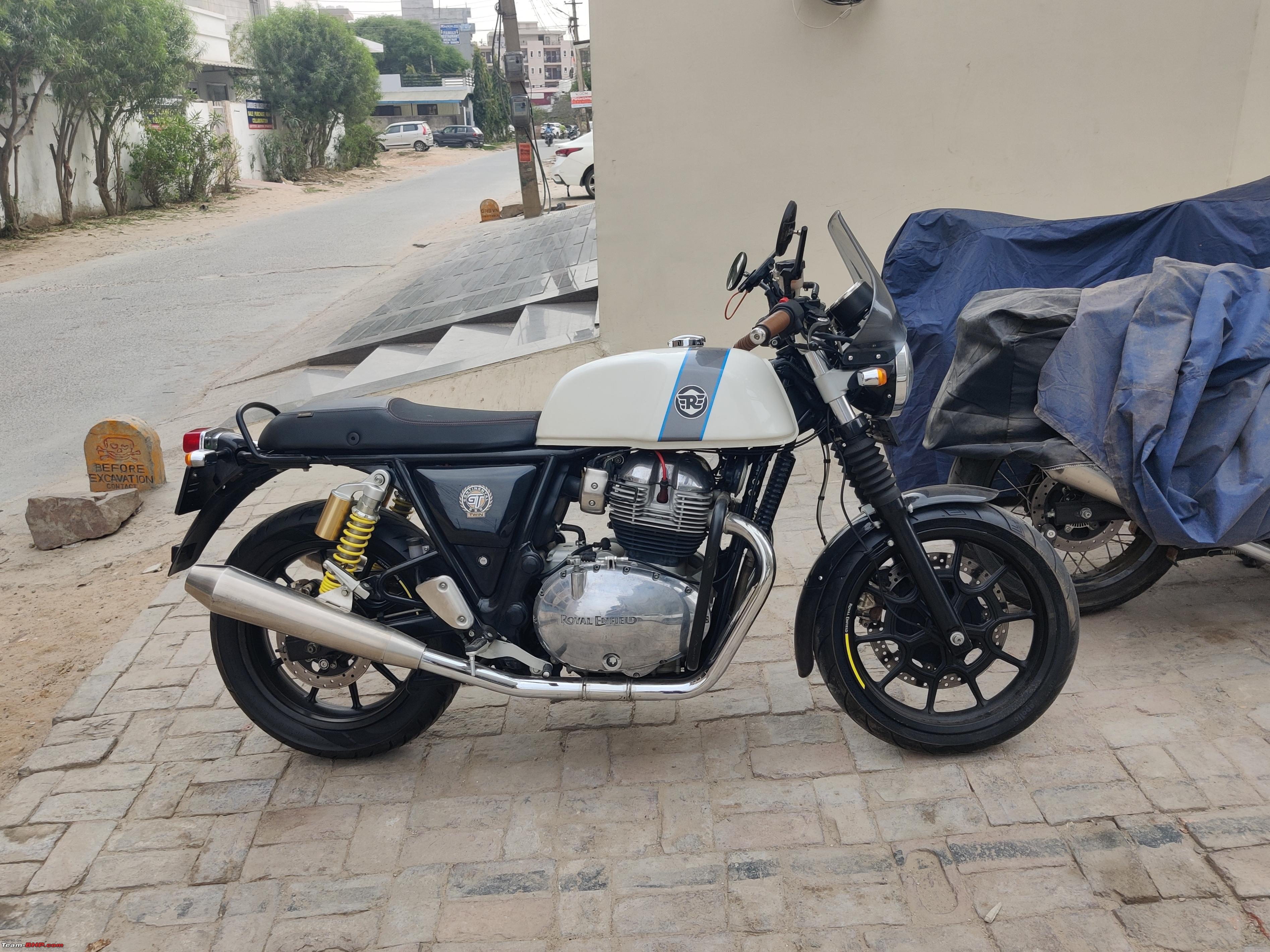

My FNG and I have managed to fit the Hunter's 17 inch front rim to my Continental GT650. Needed to get 2 parts fabricated.
1. An adapter plate to fit the GT650's brake disc (with 6 bolts) to the rim (5 bolts).
2. A custom spacer for the speedometer cable.
Has the same benefits and drawbacks as any other 17 inch conversion with the added bonus of close-to-OEM finish and aesthetics.
I saw someone above wanting to swap their old switchgear with the new one. Apart from obviously needing custom connectors since the wiring harness is different, you would also lose out on fitting the BS3 headlight switch from the 500s in case you have an aux light or an aftermarket headlight installed.
Ridden: Royal Enfield Interceptor 650 & Continental GT 650 Twin-img_20240327_120332.jpg
sab3r2th is offline   (5) Thanks
