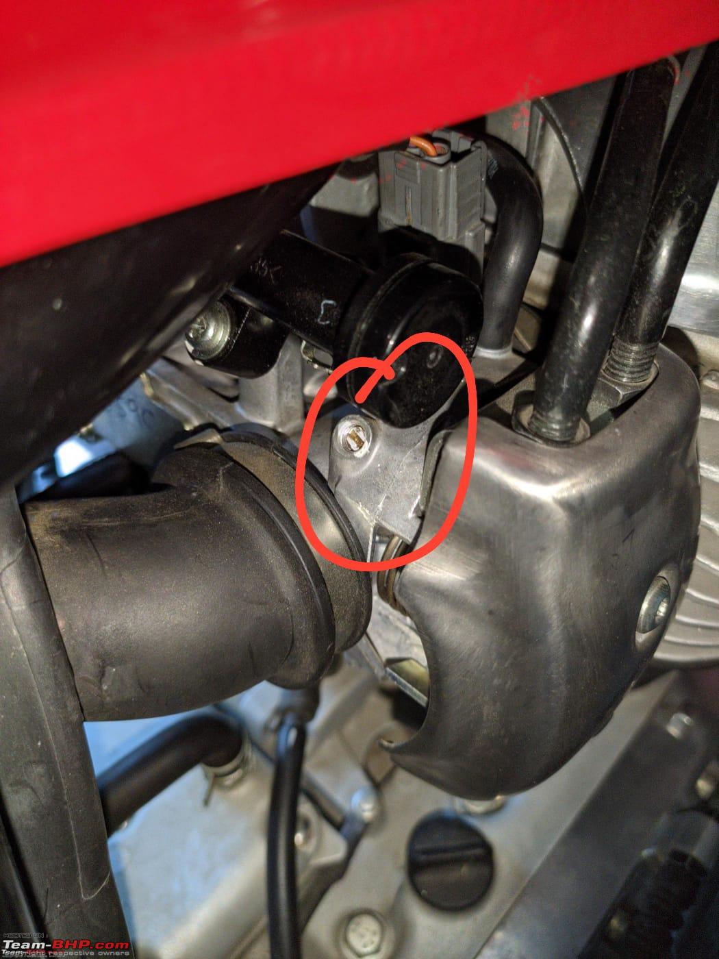

Have you checked the fuel system? A clogged vent tube from the fuel tank, water seeping into the tank because of a broken fuel cap seal, a clogged fuel filter can cause these issues.
Also, see if the brass screw shown in the picture, which are on both sides, are set in the same number of turns. If they are different that can also cause erratic idle rpms.
