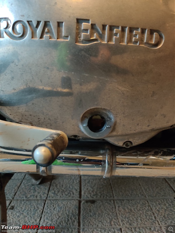

Engine oil change at FNG
I have covered around 4k kms since the last oil change in the beginning of this year. Read details here (Ridden: Royal Enfield Interceptor 650 & Continental GT 650 Twin)
I always wanted to change the stock RE synthetic oil to something available off the shelf.
Synthetic Oil options for 10W 50: (Budget group)
Motul 7100 - the best tried & tested option in my opinion
Castrol Power1 Ultimate - too much promotions and influenced choice!
Ridden: Royal Enfield Interceptor 650 & Continental GT 650 Twin-img_20221021_161352.jpg
Shell Advance Long ride - I had purchased a bottle of this from Shell bunk (petrol pump), hence purchased 3 litres more and used 3.1L for oil change with new oil filter. Not many know about this oil.
The above opinion is purely personal and nothing technical about it. The only good thing I found on the Shell oil is that it's mentioned oil change interval is upto 6k kms and not boasting of some unrealistic figures!
There are many more exotic (read costly) oils like LiquiMoly, Silkolene, Amsoil whose effectiveness is beyond my comprehension and usage!
Ridden: Royal Enfield Interceptor 650 & Continental GT 650 Twin-img_20221021_164958.jpg
The oil change process was held up by the oil filter procurement by my FNG. I didn't push him much but he said it was not easily available!
I carried out the process at my FNG so that there is no mess of collecting the used oil and also I didn't have the oil filter removal tool which my FNG purchased as his investment.
Ridden: Royal Enfield Interceptor 650 & Continental GT 650 Twin-img_20221021_165910.jpg
The process in steps:
- Warm the engine (short ride to the garage)
- Cool it a bit, the down pipes can burn your hands
- Remove the bash plate (I've the OEM one)
- Remove the drain bolt and drain the old oil
- Remove the old oil filter
- Clean the dripping oil marks
- Put some oil in the new filter ring for better sealing! (practice)
- Fit the new oil filter
- Refit the drain plug with the aluminum washer (some replace this washer everytime)
- Open the filler cap and pour in 3.1L fresh oil (some say to keep the filler cap open during the oil drain process)
- Check the oil level at the window after you start the engine and allow the oil to settle.
- Check for leaks and refit the bash plate and you're ready to roll
Ridden: Royal Enfield Interceptor 650 & Continental GT 650 Twin-img_20221021_172947.jpg
Next day I had to battle city traffic only and no open stretches but new oil is always sweet to ride!
RE recommends 1 year or 10k kms oil change interval for the 650 twins, I wanted to change the oil hence did this. But I think 6k kms is more than enough to change the oil. My odo is nearing 14k kms.
