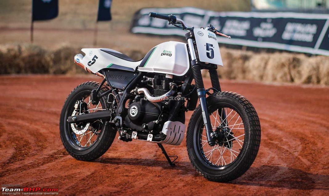

The Royal Enfield team managed to place 6th in their first race and for a newcomer to the sport, that's commendable.
Flat track is catching up in india. We have one close to Bangalore too where the bikes are customized for flat track and sponsored by RE such as these.
Ridden: Royal Enfield Interceptor 650 & Continental GT 650 Twin-royalenfieldhimalayancustomflattrackersibw201961068x636.jpg
