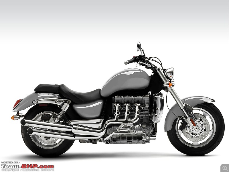

I have attached a Rocket 3 Pic, this is the look i am after. i have managed to bring the base platform very close to this. In a time when every one in the market is working very hard to make there small mopeds look big and powerful, i have worked quite hard to make it look Normal and usual motorcycle( i would not say small motorcycle).
when i used to bring my Zen engined motorcycle onto the streets of the town, it usually ended up looking like a bike rally within 15 mins, followed by tution going students and autowalas and even cycle walas, trying to know *** is on the road.
What is most amazing is that i now have managed to use an engine twice the size and weight (Gearbox also almost twice the size of zen gearbox), and still has managed to actually reduce the wheel base by an inch as compared to Falcon's avatar(with zen engine).I guess this is also India's first ever Crdi motor transplant,is it?
Another amazing thing is that this bike runs with such a low noise signature that general public on the street does not even notice that something unusual just passes them by. There are no panels rite now, and i have been on towns main streets 3 times, and .....Nothing.. no fuss no mela atall.I was followed by only 2 motorcycles on our latest run, one of the guy came alongside, asked me which bike , what engine ,top speed etc. he was surprised to know it was diesel, I told him it was 6l V-8, poor guy believed me and went away happy thinking he witnessed a V-8 bike in india.
I see the bike daily and to me it would appear great and goodlooking, but my friends tell me it does not look unusual even without the paint and panels. according to them it looks good on the run and has some road presence aswell.

Project: Creating the world's fastest TurboDiesel Motorcycle! Road test video added-tdi1.jpg
