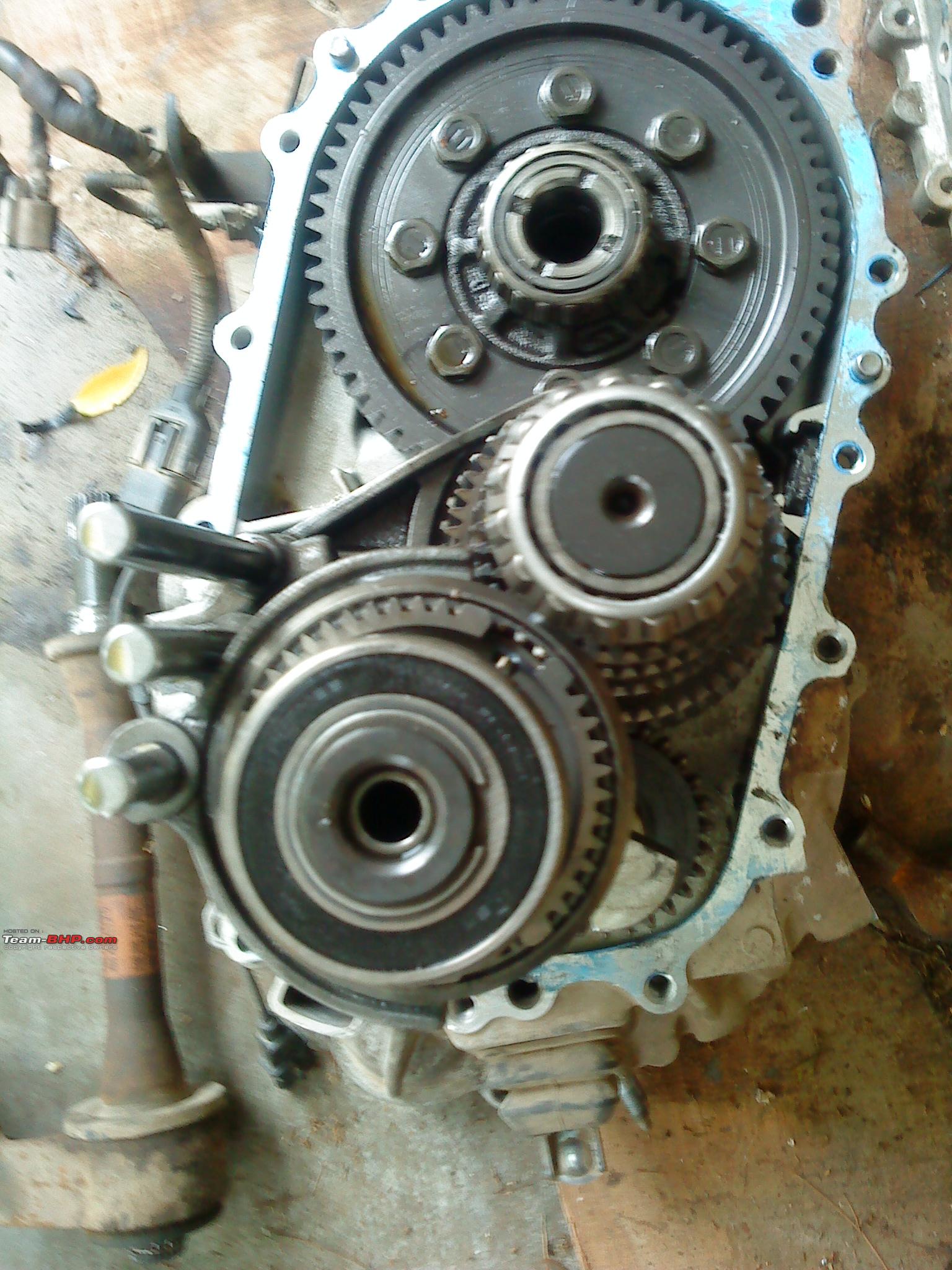

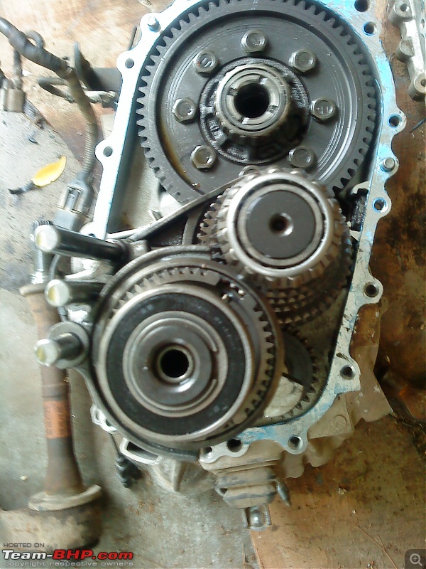

work on gearbox has been started,differential will be removed and lay shaft/counter will be redesigned.ordered a few parts online aswell.can anyone tell me where can i find alloy wheel 10"wide-11.5"wide 16to 18" dia will do. i would be puttin on a 280 or 300mm tyre,so i need a pretty wide rim.
