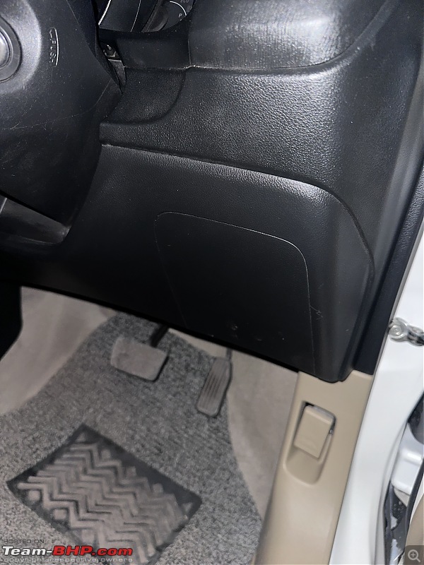

I need help . Does anyone have a small openable glovebox type box under the brio steering wheel where the fuse box lid is ? I am attaching a picture. If anyone has can they share an image .
Honda Brio : Test Drive & Review-img_7816.jpeg

Pictures of Brio June 2012 V MT model are attached in for reference. No glove box present, also there is hardly any space with the fuse box location.
Honda Brio : Test Drive & Review-20250309_2303561920x2560.jpg
Honda Brio : Test Drive & Review-20250309_2304231920x2560.jpg
