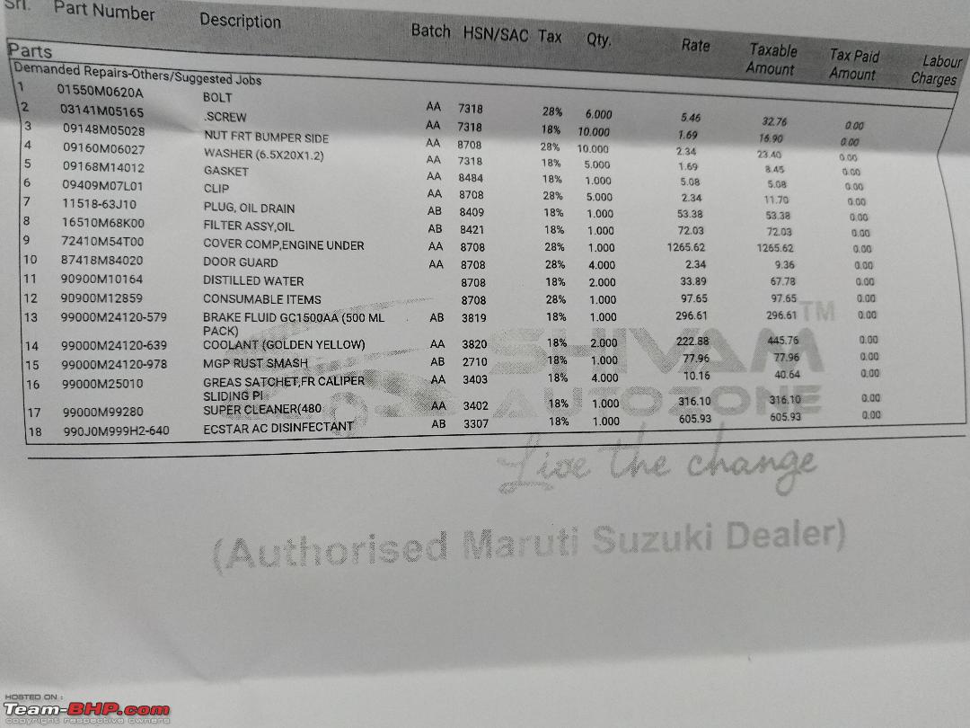

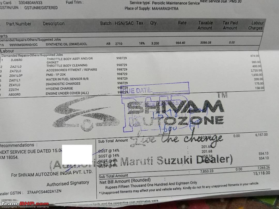

Had given the car for it's 4th paid service and got a nice fat bill of 15k. 1600 was for the engine guard and 200-300 for labor etc so if we minus that it comes to a unbelievable for a Maruti ~13k. ~200 was charged for sanitization and I do not know what was done really for that. Cooling coil was supposedly cleaned and dashboard was to be removed and fitted. I told them there not should not be any issues post the remove re-fit. Maybe this was not needed. Throttle body etc was cleaned as well. I asked not to do alignment balancing as I get it done outside.

I'd like to point out the mistakes they have done(from your perspective) and ended up fleecing you/doing harm to your car.
1. Using gasket 09168M14012:This is meant for older engines with Iron/Steel sump like M800. All new engines use 09168M14015 which is meant for aluminum sump.
2. Pushing useless stuff like Super Cleaner and AC disinfectant. Do realize that all new cars have a Cabin filter and coils don't get clogged that easily. Completely useless.
3. Throttle body Cleaning: Entirely useless for a car run less than 20k and do note that they have charged labor two times for basically doing the same thing. Also do note they have taken labor for changing TB gasket but not used the gasket itself. You can challenge them for this. Basically they have sprayed some cleaner in your TB and that's it. And no way can they use all contents of the cleaner bottle in this. It's daylight robbery.
4. Using wrong grade engine oil: When 0w16/0w20 is recommended, who authorised them to use 0W40 ? Pure profit. 3.5L can of 0W16/20 costs ~Rs. 1500. 0W40 costs more than Rs. 3500 for same volume. Both are fully synthetic, 0W40 costing more because of wider viscosity range. If this is escalated, they will be forced to put correct grade oil and return you the money.
5. Water in Fuel Sensor R/R: This is another scam. Someone please show me where this sensor is in Petrol Marutis!
6. Diagnostics charges: For basically connecting their scan tool, which is part of the paid service if needed. They have charged you separately for that.
In short, almost 7k worth of stuff is useless in your 15k bill. I seriously recommend escalating this to MSIL. Unless escalated, this keeps on increasing the morale of the dealers. Simply complaining on forums like ours doesn't change anything unless some initiative is taken from customer's end, along with familiarizing yourself with all service items mentioned in owners manual.
Apologies for posting this so bluntly but the "loot" has ruined my mood. The PMS itself is on the higher side I believe. Did you visit their NEXA service by any chance??
