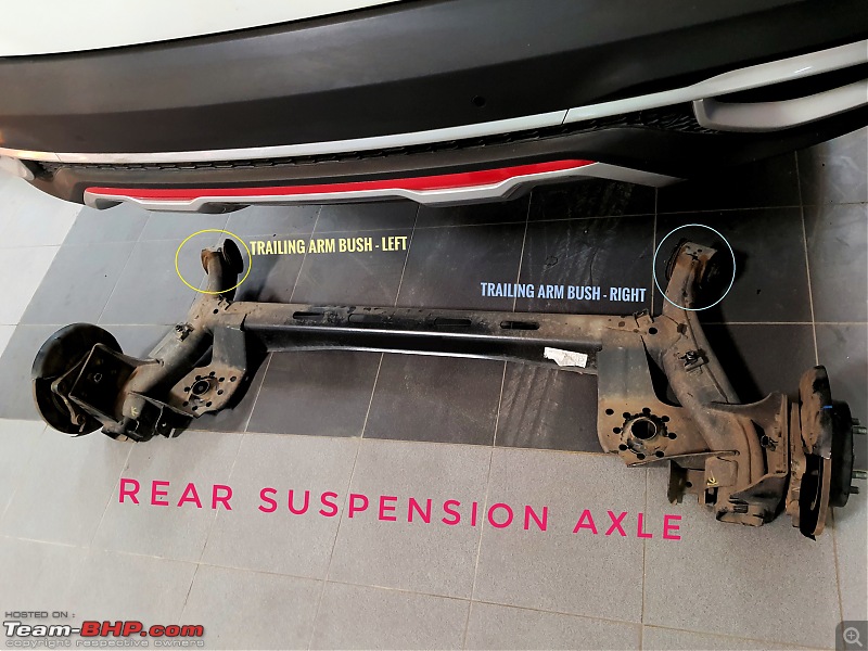

Update on the squeaky noise from the rear-suspension: Applying grease also didn’t work-out and the noise came back to haunt me. I immediately had reported this to the same service center and Mr. Kumar (AGM Aftersales) from Car Kia confirmed on reporting this to the manufacturer and take their confirmation on replacing the “rear suspension trailing arm bush”, which was finally confirmed by Kia for a replacement.
While the part hardly costs approx. Rs 2,000 for a pair; the amount of frustration it caused all this while, was immeasurable.
Replacement of the part hardly takes less than a day; while the twist in this endeavor was – the special tool used by Kia to remove these bushes from the rear-axle just broke-away. These bushes were so tightly fitted, that even the tool succumbed to death. And now the service center had to transport the rear-axle to a lathe machine vendor, to replace those bushes. This took almost 1-day to complete and I had to pick up the car the very next day. Finally, the car is running smoothly sans the frustrating noise. Have confirmed to the service center; I would be observing this for a while and report back if there are any issues.
Thanks to Kumar for helping me take snapshots of the trailing arm bushes for the benefit of a larger audience here (attached).
Kia Seltos : Official Review-kia-1.jpeg
Kia Seltos : Official Review-kia-2.jpeg
Kia Seltos : Official Review-kia-3.jpeg
Meanwhile, Kumar did confirm the steps suggested by Kia, if customers complain of similar issues in their cars:
1. If a customer reports "suspension squeaky noise" for the first time; the action plan is to spray a lubricant on the trailing arm bushes.
2. If the same customer comes-back the second time complaining about the same issue; the action plan is to apply grease on the same area (trailing arm bushes).
3. If the same customer again comes-back for the third time with the same issue; the action plan is to request for a replacement of the trailing arm bushes.
Please do review your cars for any noise from the suspension area and report it to your nearest service center. This will also help Kia to review their quality check parameters
