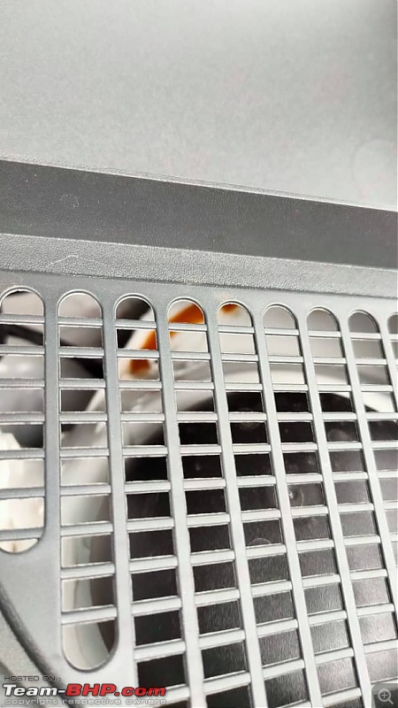

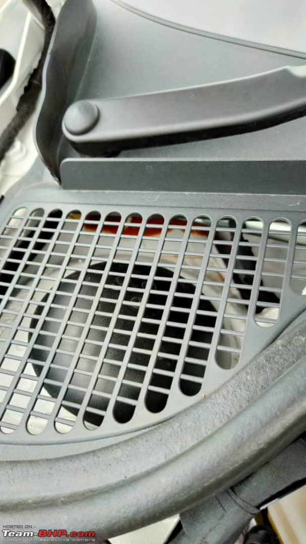

After a long wait and after changing 2 VW dealers due to various reasons, on 8th Jan 2021, I took delivery of my VW Polo 1.0 GT TSI.
Now see what I got, in a car driven less than 40 km.
I had filled fuel worth RS 2000 (HP Power) from a pump from where I was filling fuel for almost 3 years. After I reach the next traffic signal this popped up.
I called VW service centre and also roadside assistance. They said not available today since Sunday. WOW!
Finally got a chance to speak to one of their technicians after I make 4-5 calls. He had asked me to drive home slowly and they will send a roadside assistance tomorrow to check what it would be.
I was about to go to a place which was around 80km one way and this happened after I crossed around 10-15 km from my home. I had to cancel the trip and come back. I was with my family including 2 small children.
Interesting enough, when I popped open the bonnet I saw a brown coloured liquid in multiple places. That smells like grease, but initially, I got a shock while seeing that thinking its the engine oil.
But upon a detailed check, I found out the brown liquid was present under the windshield at both ends. Have a look at the photos.
Other than this I did not notice anything. Anyone could advise?

That's really shocking in a brand new car, engine oil leaking is possible(even that's rare) but the oil reaching all those places, that's seems really weird. Write an email to volkswagen or call the customer support so that they are also in the loop, something is really wrong with the car, or maybe there might be something else.
At the service center talk directly to the manager and ask for the contact details of the hire ups and let them know of this issue as well. Don't leave the car and ask them to fix it in front of you.

I have checked that in detail. That is not engine oil nor there is any leakage to my eyes. But the check engine light still remains. From the owners manual, it seems like a problem with the oxygen sensor / catalytic converter problem.
Nonetheless, I have already escalated that to the service centre and also to Volkswagen customer care by call and also by email with those photos.
They have assured to send me their team by today to check the issue as I have insisted to check the car only in my presence.
But by any means, this is not acceptable on a brand new car. The earlier car I was using went to the service centre only for the scheduled maintenance and for nothing else. So even my family is quite irritated about it as it is a brand new car.
Let's see. I will keep that posted here.

I had this same issue in my brand new Octavia 1.8TSI at 200 kms on odo in 2015. The check engine light came ON and on scan it was the oxygen sensor in the exhaust gone bad. The part was not available in India and took almost 30 days to arrive from Czech. Till then car was grounded and i was given a (very used/abused) Superb as a spare. After fixing the new sensor, no issue.

UPDATE: I have just come back from the VW service centre. As I was suspecting the brown liquid was GREASE. A lot of it. I don't know why VW was putting that much grease into the engine bay and to the body panels.
Somehow, it was present in almost all new cars. My sales executive showed that in multiple new cars including the ones at the showroom (Polo & Vento). So I am convinced.
Comes to the "Engine Warning" light. According to them, this was mainly due to the fact that when the car arrives from the factory it will be filled with good quality BS6 fuel. But in Kochi at least, the quality of the fuel is not that good unless in some pumps. They have scanned the car for any error codes and fuel quality was the only error. They have adjusted/erased the error.
Now the car is back in fully functional condition.
However, the "Engine Warning Light" along with the siting of this much grease caused some turmoil as the car was brand new.
Anyway, all is well at the end. Hopefully, it will remain that way.
I hope this may help someone who was/is/will be in similar condition.
