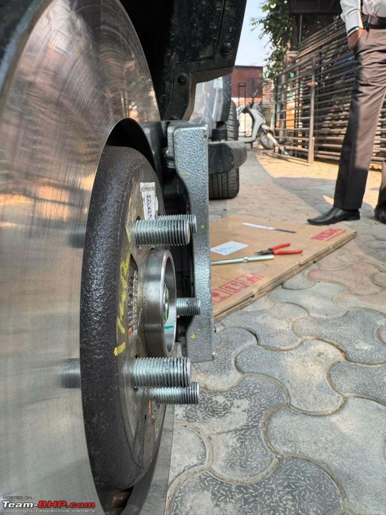

Originally Posted by Monti View Post
I'm not sure what the bore size of the OEM wheels is.
OEM
CB: 63.4 (maybe)
I have doubts on this, per the guy who sold us wheels, OE is 67,1
Proman is also 67,1 both sides. Maybe some other member (Roxx owner) who has access to measuring instrument can check on this. I will also try to measure up and update.
Someone needs to measure this on his Roxx or at service center
Thanks, I'll try to measure as well. If the CB is indeed 67.1, then I don't think there's any issue. Unfortunately, I can't find these details in the manual or on the website.
Did you install aftermarket alloy wheels? Did you use a 25mm and 32mm spacer setup? I'm worried that with a -10 offset and a 32mm spacer, it might hit the bumpers on inclines and sharp turns.
