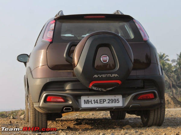

Got the HTK optional Gasoline in grey for my dad. The car is good and spacious but for some weird reason tyre pressure goes up by 5-6 units after driving for a while.
Also, do you think we'd be having spare tyre mount accessories in the future?
Congrats on the car! The tyre pressure going up is completely normal. As the tires get heated up, the tyre pressure also goes up. That is why manufacturers recommend to check the cold tyre pressure.
