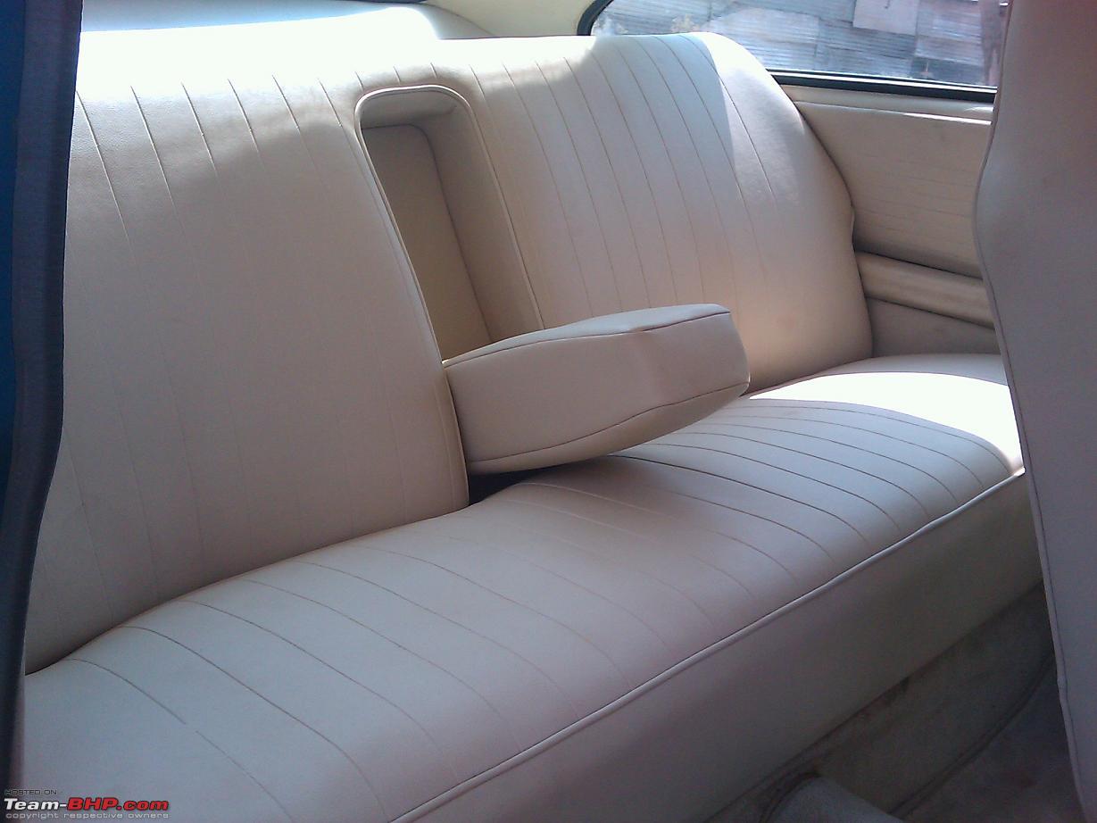

Good to see the car finally done! Great job Pavan! The interior especially looks yummy!
Where did you procure the original rear glass from btw? Imported it?
Also who's the dude in the red tee standing next to the car?
