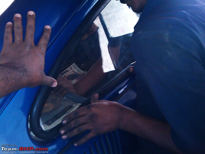

Side glasses are fitted today.
The painters started their work of rubbing and polishing.
The only thing pending is the Upholtery guys. Waiting for them to do the seats and finish the job.

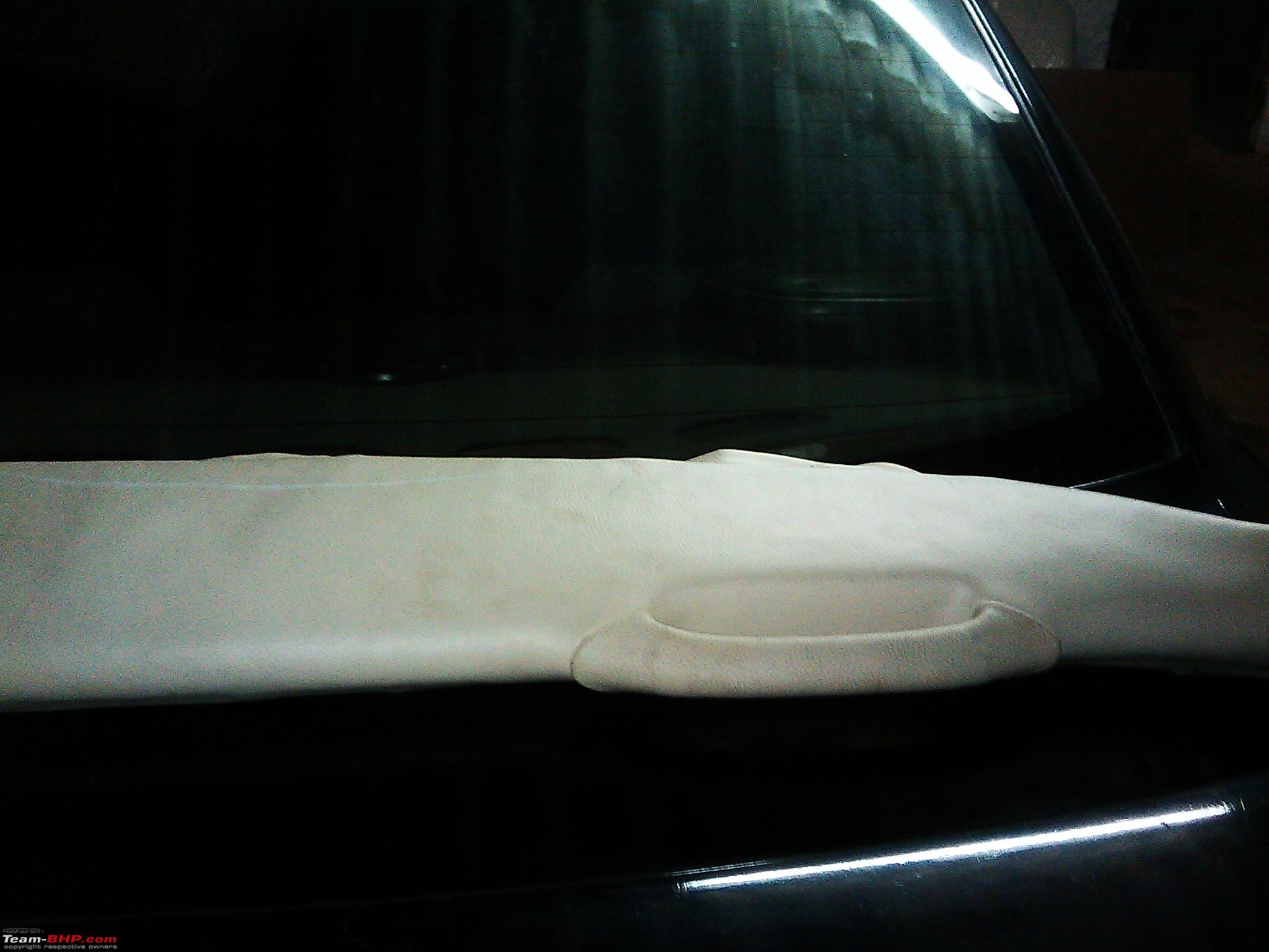

Some glimpse of the Seat design.
This is still posing a great threat to our work completion.
There are only 2 front seats without the bottom and the rear seats are of a Squareback, which is entirely a different design in the Fastbacks
I have been promised that the complete upholstery will be done before Wednesday. While this is being done, the car is almost done, with only 3 pending things

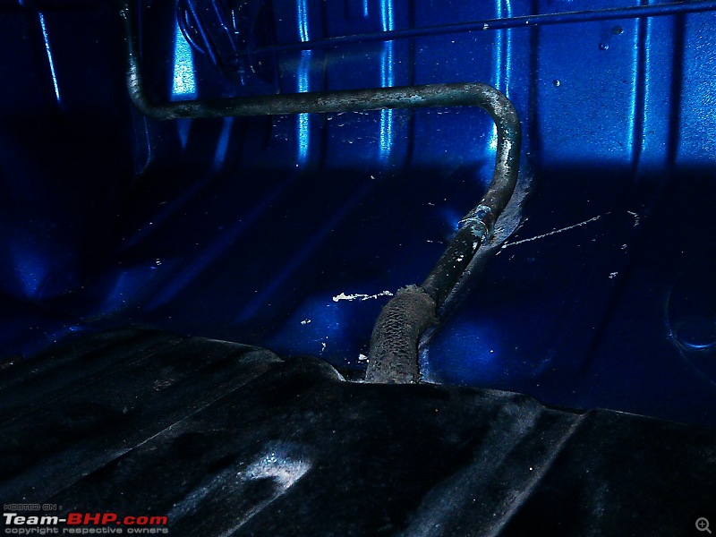

Today the Fuel tank was cleaned with Petrol, Inspite of cleaning it earlier, there were lots of rusts inside.
Presently there is 1 litre of petrol and 500 ml Engine oil in the tank, Will be drained out tomorrow and the tank will be ready for further use
The car is ready in all aspects, the work on seats have taken a backseat due to the absence of the rear seat with armrests. Wednesday the car will be fully ready. My last Weekends deadline is beaten. due to my travel for 3 days and due to Holy Mohurram.

1) We fitted the Fuel tank 2 days ago, one hose is found with a loose end, what comes there.......???? Went through the manual and found it is a fuel tank vacuum hose. Since we did not have one in the car, it was a usual practice to find one in the junk yard, and this part matches with the usual variants. so i had spoken to one guy in the junkyard last time when he provided me with the Intake manifold. Went back to him, and he had this hose, Got it and it fitted to the tee. Sourced another rubber hose locally to get it fitted finally.
