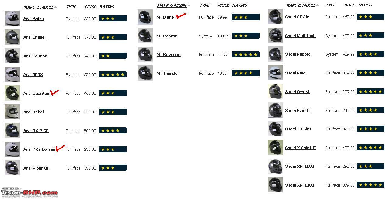

So finally we have the MT Blade also given its SHARP rating, and surprisingly it gets only 3 stars vs the 5 stars rating for the Revenge.
But then it should not be surprising, the way helmets from the same manufacturer get wildly varying ratings, I wonder if it isn't better they published the actual force measurements to each of the measurement points instead of an overall rating and the schematic showing the color-graded injury index to the forehead, temples and back of the head.
Second, lot of "experts" , both self-proclaimed and those who (allegedly) work in the helmet manufacture/supply/dealer business claim that Arai is undisputed #1 and the safest helmet anyone can buy eyes-closed, any model of theirs.
But check Arai helmet SHARP ratings and even highly acclaimed (by magazines and journos abroad) models like the Arai Quantum and RX7 Corsair have a piddly 3 star rating. Same as MT Blade. And some Arai lids have less - 2 stars, when none of the MTs are below 3 stars.
I have been thinking of getting another helmet, my MT isn't terrible but it is a bit louder than I like and the vents seem superfluous, and does wobble a bit on rough patches despite the snug fit. Now I wonder, if I should pay big once and get an Arai/Shoei , which everyone and his nephew seem to endorse despite not having personal crash experience, or any scientific basis to endorse other than , "hey you don't see Pedrosa , Lorenzo or Marquez wear MT despite being Spaniards, do you ? No, they wear only Arai (Pedrosa) or Shoei (Marquez), the top riders".
Of course, a certain 7 time champion wears a lower credibility (read: el cheapo ) brand , namely AGV , but to these experts, that's only because he has part-ownership stake in it.
The real issue that Moto GP gear and commerical models are, or could be, far different in terms of quality is lost on at least some of the self-proclaimed experts, it seems. That Lorenzo now wears HJC, from a Nolan (XLite) earlier, or that Stoner wore a Nolan too, is immaterial, I suppose.
