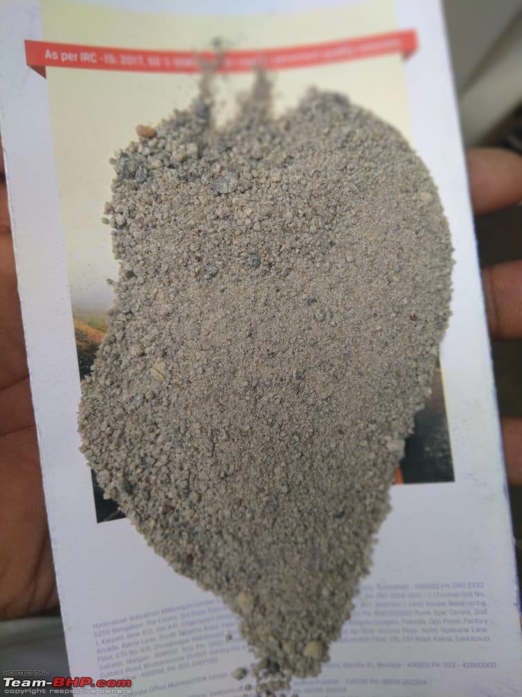

Hi Fury,
thanks for the contact. Can you also share a pic of how the slag cement looks like ? the crushed also if you can. Thanks.
Hello Condor,
Attached Slag Sand picture for your reference. It's very fine and does not contain any dust particles, this feels just like river sand but without any wastage.
