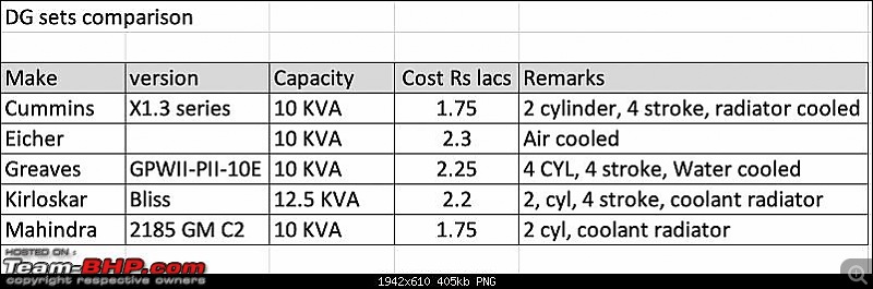

10 KVA Genset
While on the subject, require advice for finalising a Genset. Offers are as follows:
Home Construction / Makeover / Maintenance Thread-dg-set.jpeg
Would welcome advice. Thanks.

There are a lot of costs involved in owning a generator.
Apart from the initial cost, please find the following :
1. Service interval in hours
2. Service cost - both parts and labour
3. Major overhaul interval, as well as its cost
4. Fuel consumption at your stated load
Once you get these, you will be able to calculate the "cost-of-ownership" over the life of the generator.
I would always prefer a 4 cylinder over 2 cylinder engine both from the point of view of smoothness as well as from running costs.
Any difference in reliability? Thought 4 cylinder vs 2 cylinder would be relevant for smoothness if on a vehicle.
My guess is that the smoothness here we speak about is related to the way the alternator is driven. In a two cylinder engine, the power strokes of the two cylinder would be followed by one non powered stroke after which the second cylinder would fire. In a four cylinder engine this would be continuous, ie every stroke, one cylinder would fire. The result is that in the non powered stroke of the two cylinder engine, load on the alternator could create a drop in engine speed and there by frequency of the output, whereas in a four cylinder engine this would be much stable. This is just based on my understanding and am open to correction.
