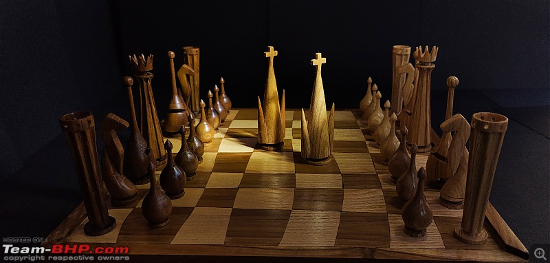

Got an opportunity to make this custom chess set based on the original design by Nihal Aarons. Nihal did the complete 3D design and I was provided with 3D drawings of the board and pieces, my job was to create the real stuff out of wood. This was a very tough one to make given the details on the chess pieces and their size. The board is just 30*30 cm and the height of the pieces range from 6 to 10 cm and diameters from 2 to 3.5 cm. A wide variety of skills were used in the process including hand carving, power carving, wood turning and scrolling. Dark shades are made from teak and the light ones from white ash.
3D render of the concept
and the final product
Can be fixed on the wall as a display piece too
The pieces on display
Close up of some pieces.
And one last pic.

Demo pieces for color selection. From left to right - Rosewood(Eety), White ash and Teak. Client picked brown and white pieces.
The hardest one to make was the queen. It took 3 attempts to build the perfect one.
Board after fixing all the individual 64 pieces on base
After completing the darker pieces. You can aslo see the board pattern at the base. The pattern is used to cut out the individual pieces
The lathe
The queen's crown in progress.
