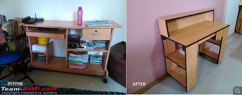

4) A neighbour had this MDF board computer table and asked me if I can fix the slag in top, I chose to RESTORE it at marginal cost (2.5k).
95% of the table is original material with new laminating and ofcourse the design.
