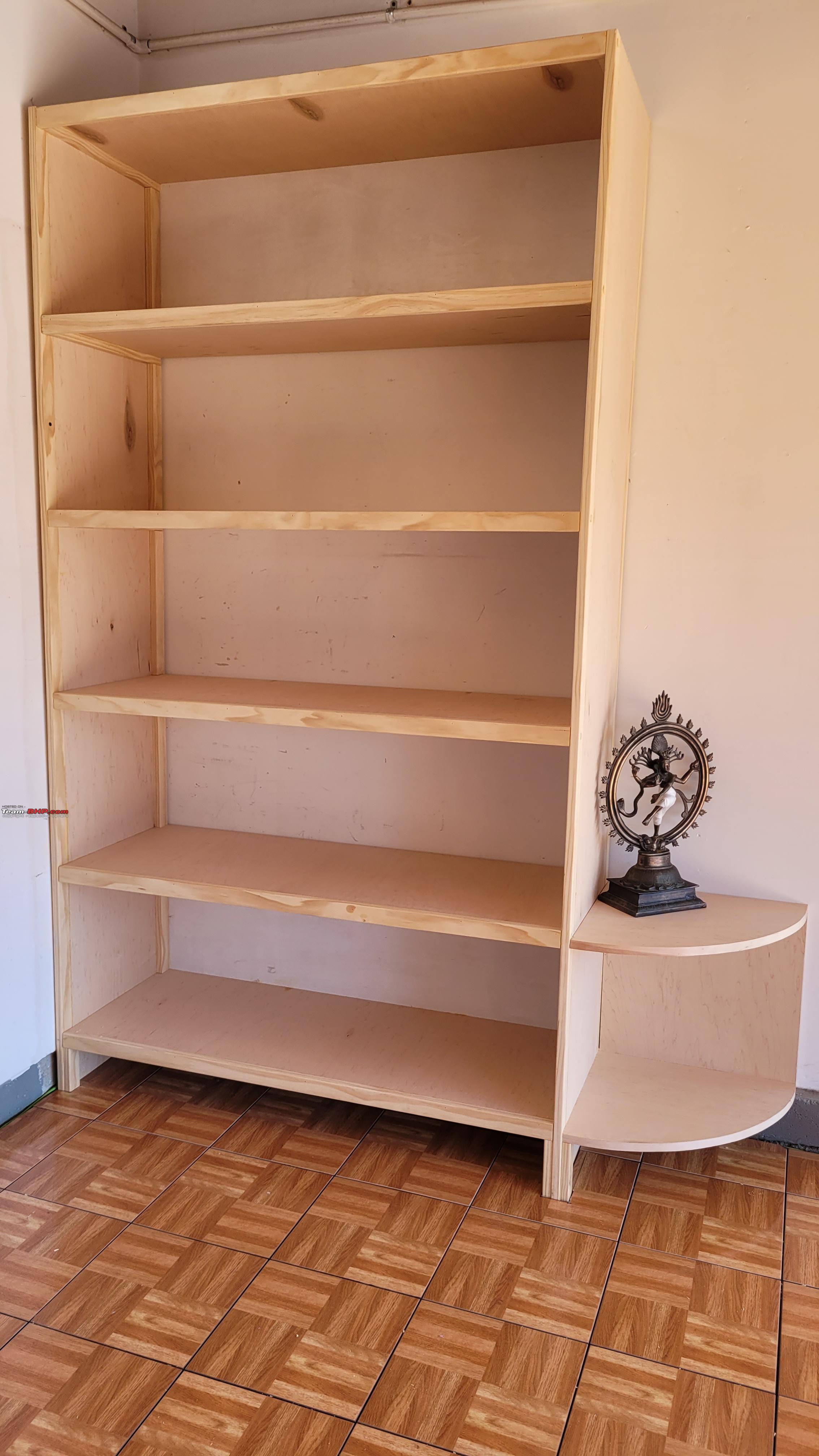

This one was ordered by the boss. She uses our garage as her dance studio, and she needed some storage. 3/4" plywood with pine edge banding. I made it out of 2 sheets of plywood with no wastage. Designed to carry 10 big boxes with garments. I usually end up with bunch of extra plywood lying around. I guess I am getting better at making my cut list and sticking to the design/plan. No scope creep.
