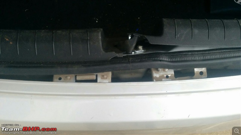

I am not sure whether to post this here, in the Insurance (ask me) section or the xcent official review forum.
Xcent got rear ended a couple of days ago. Initially thought that it was only bumper damage, but I returned home to find the boot also damaged. The boot would not close.
Gave it to the Hyundai workshop and as expected they have given a big estimate. I'm most likely going the insurance claim way as getting some tinkering etc done at my own expense may not be a good solution for this damage.
Attaching pics of the estimate and the bumper damage:
1. Is it worth trying to get the job done with some tinkering and just making it functional and keeping the personal cost to less than 5000 Rs.
2. Will a nil depreciation insurance mean more than 1000-2000 Rs cost to me?
I am with Royal Sundaram for Insurance
Unfortunately they don't have a cashless tie up with Jains Hyundai. How long does the reimbursement process usually take and will I know the exact out of pocket expense before I approve it?
I'd recommend not; no upside to this. The locking mechanism looks damaged so I don't think tinkering can solve this; at least enough to make the boot perform flawlessly. Bumper can't be tinkered, based on the damage.

Did you lift the spare wheel to check if the structure is intact? In my case, there was a slight bend in the boot floor too.
Also, HASS repainted the boot door and bumper (black) but the paint job was really shoddy. Ensure that your service centre has the ability to properly cure and bake the paint.

The rear structure which holds the door latch seems to have been pushed in which isnt letting the boot close. But a jugaad way will be too crude, that is by pulling back the member to its place. Hence, its better to get a new panel welded. But what I dont understand is why on earth the ASC wants to go all the way to replacing the rear glass and some wiring harness. Does that mean they will cut and weld the whole rearside of the car? Please ask them to demonstrate which all parts they will be replacing, especially the body panels. I dont think the crash would have led to deformation all the way till the rear glass and surroundings.
Also, like mentioned by others, please ensure that all the inner parts in the wheel well, boot are welded and painted properly. Else, you will face issues with water seepage or rusting.
