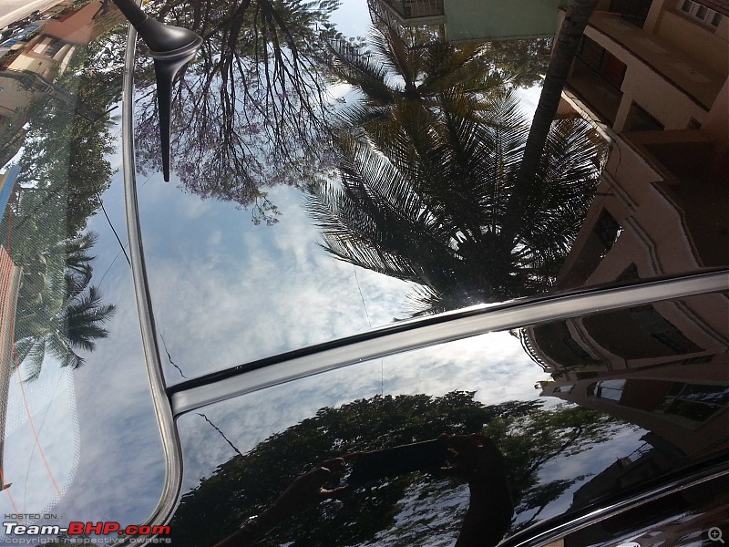

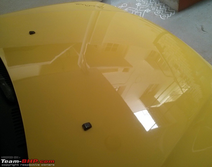

Wet sanded entire car again; love the results
All the pics are after compounding; no polish or wax applied yet. Finished polishing and waxing late in the night so no pics of them

Old 10th March 2014, 08:32   #8360
SunnyBoi's Avatar
Location: Mysore / B'lore
Posts: 1,720
Thanked: 4,461 Times
Re: A superb Car cleaning, polishing & detailing guide
All Done

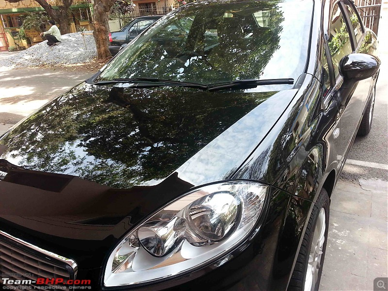

Tried my hand at a detailing session over the weekend. In the excitement to get started I completely forgot to take pictures before and during the detailing. Quite happy with the end result though.
Steps and products used.
Pressure wash using the Skil pressure washer. ( Meguairs NXT shampoo )
Clayed with Ultima Esatrofoam using Ultima waterless wash as a lube.
Compounding using Meguairs M105 with a Dewalt Rotary
Polished with Meguairs DACP
Finished with Meguairs M21 sealant.
Here are a few pics of the results. Excuse the quality as they were taken with my phone.
Scorpioman is offline   (7) Thanks
Excellent work done. The black color is looking absolutely perfect, just out of factory.
