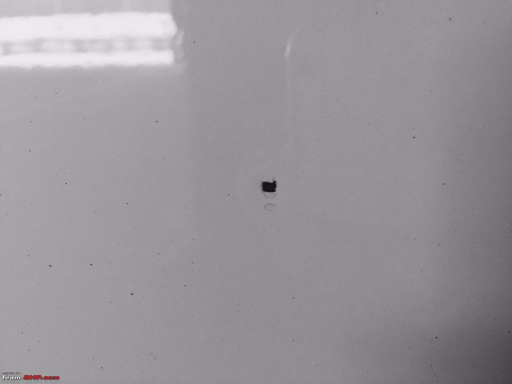

Alrighty, detailing experts. Let's see what you make of this.
There's a small dent on the front left door, courtesy of the 3rd free service at Express Hyundai . I'm attaching some pics for your reference.
The situation, I'm afraid, looks grim. The paint has chipped off, and I can see metal underneath. If I had to make a guess, no amount of detailing will take care of this?
So, my question is this: What can I do to make this go away? Please don't suggest repainting the entire door. That's never gonna happen. I was looking up some com paint thingy on sale at Amazon, and wondered if anyway I can fill up this hole and get it painted and clear coated? Any suggestions, fellas? Can't believe my bad luck that our car got its first freaking dent at the hands of the dumb-a$$ service people.

Firstly, this looks like a paint chip to me. If there's a dent, then the below advice would be of no use.
Get the matching com paint can. Clean the area in and around the chip using rubbing alcohol.
Then spray some of the paint in the cap of the can, and use a cotton ear bud to pick up some of the paint and fill in the chip.
This is a slow process and you need to give some time to let one layer of paint solidify before putting in the next layer.
Layer by layer, lay paint until you have a small size 'hump' - yes - the com paint deposits should actually form a little pimple on the surface of your car.
Then use progressively high grade wet sanding paper and sand down the 'pimple' to the actual paint surface.
Then polish, and protect.
Look into this forum thread as a reference:
http://www.autogeekonline.net/forum/...y-scratch.html

It will look better painted, as long as it is painted with the exact-match paint, preferably from the dealer. If they did the damage, won't they fix it for you?
I've had several much bigger dents that become barely noticable from across the road when touched up in the right colour. Up close, of course, a dent is a dent.
With metal showing, you must get something done soon, or it will soon be rust. Again, a touch-up achieves that, putting off the real repair until later

Thanks mate! Looks like some manual effort is required. Sadly, I'm a total numpty when it comes to anything related to DIY.
I've ordered some stuff off Amazon, and will go meet up my regular detailer once it arrives.
The thread you've recommended will definitely point me in the right direction.
It will look better painted, as long as it is painted with the exact-match paint, preferably from the dealer. If they did the damage, won't they fix it for you?...
Ah, but if only...
They agreed that the dent was caused by them.
Apparently, the parking space in the service bay was way too less, and the front left door hit something while being opened.
I literally raised hell when I came to collect the car after service and saw that dent.
They tried to brush it off as something I had caused earlier, but the job card said otherwise.
They apologized but said that it will take time to work on the dent. So I would need to leave the car with them.
I told them to go shove it where the sun doesn't shine, then have coitus with themselves, repeatedly, in all forms and positions, and drove out of the service center.
This was the last of the free services, so from the next time I'll be heading to some FNG.
But what's done is done. My car is dented, my heart is broken, and the paint is chipped. Hopefully Jerry from Car Cares can do something about it with the paint thingamajig I've ordered off Amazon.
