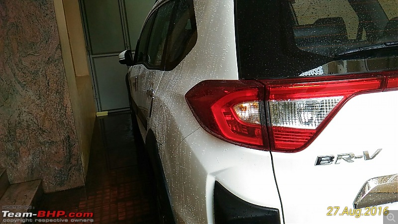

Water beading effect on my Honda BR-V thanks to C-Quartz ceramic coating -
A superb Car cleaning, polishing & detailing guide-p_20160827_113043_1_p.jpg
A superb Car cleaning, polishing & detailing guide-p_20160827_113050_1_p.jpg
Details of C-Quartz coating application in this post

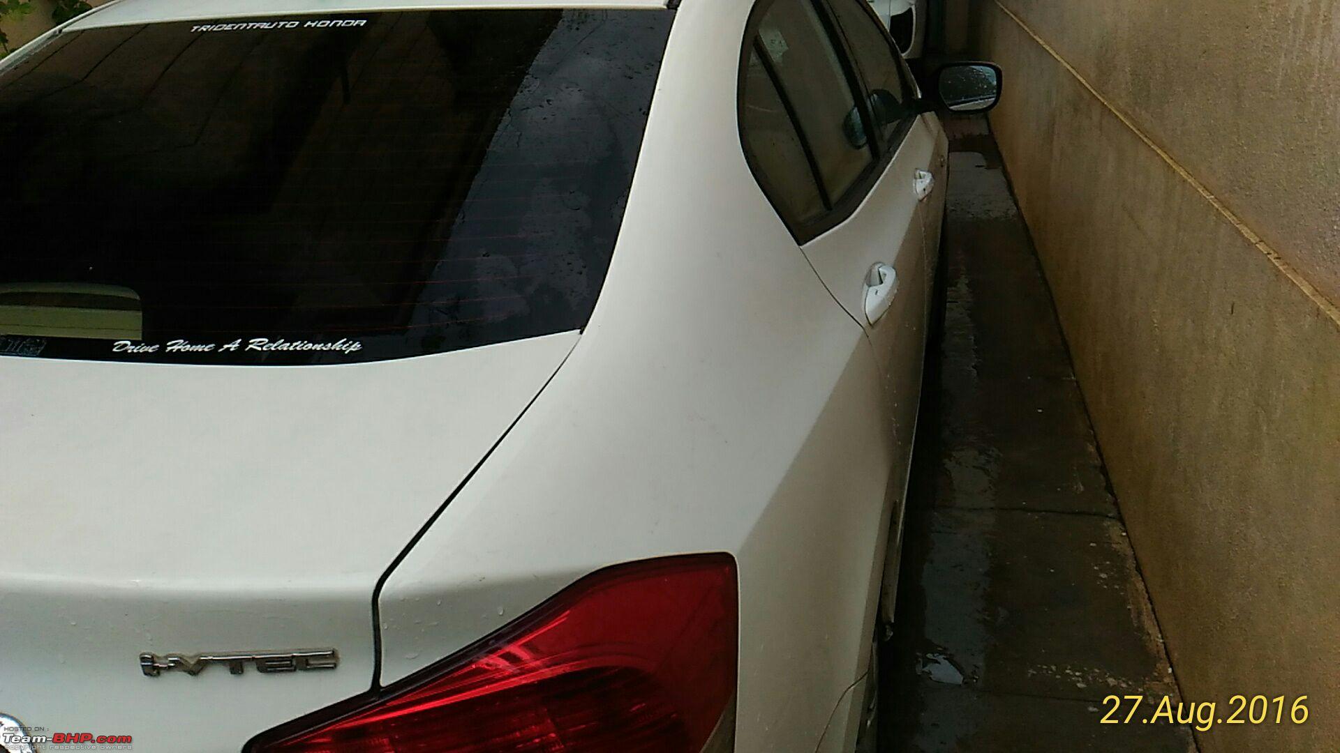

In the Honda City, there is no ceramic coating - so water sticks to the body.
A superb Car cleaning, polishing & detailing guide-p_20160827_141905_1_p.jpg
