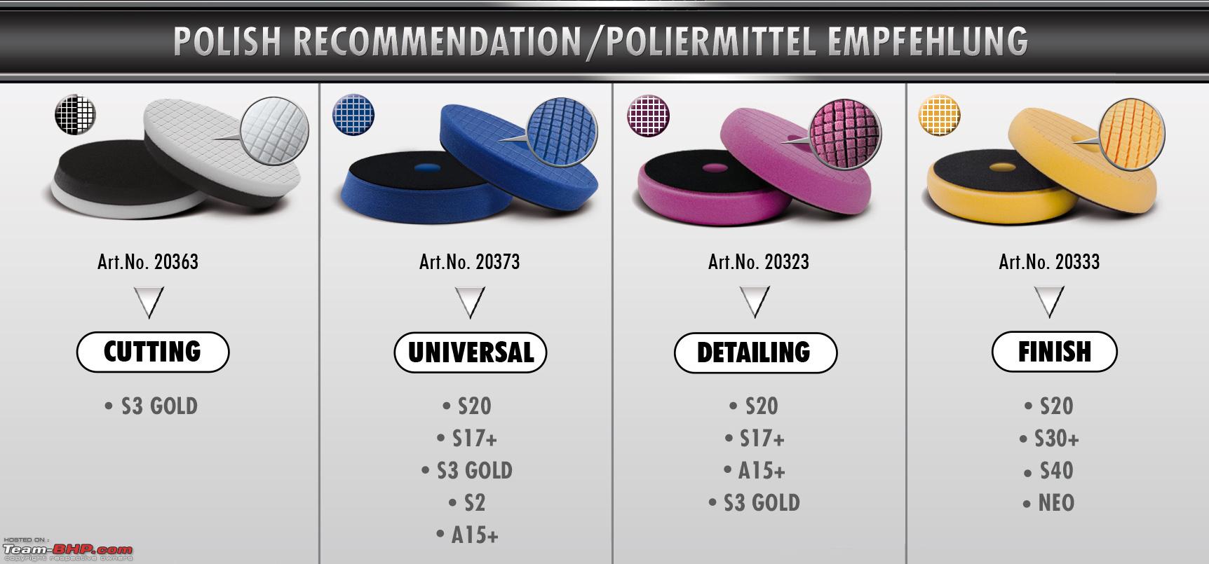

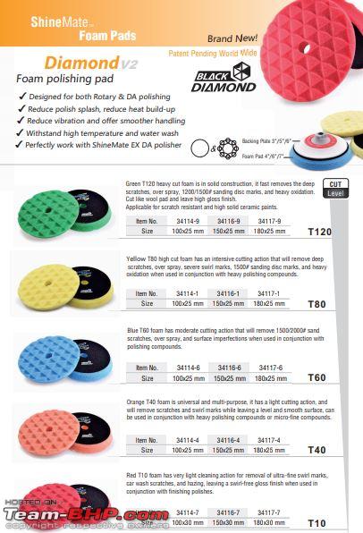

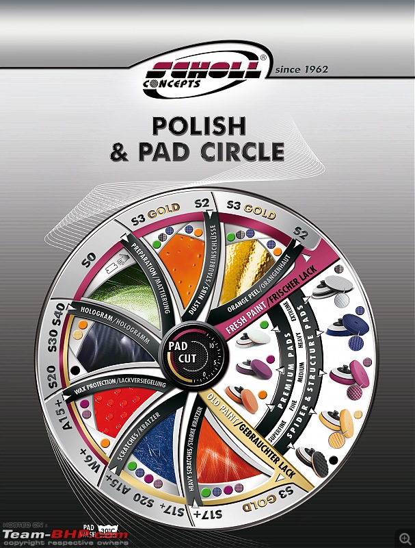

Originally Posted by shivamk11 View Post
As someone who has no experience in detailing, if I were to invest in a cheap rotary polisher. Which pads should I buy for all 3 major tasks namely rubbing, polishing and waxing. They should be cheap to buy and get the job done better than hand application. I have gone through several websites but it only gets more confusing and the pads keep getting more expensive.
IMHO it would be safer to begin with a Dual Action polisher as they are much easy to use and much conservative on the painted surface.
On the higher end you've got the Rupes machines which are like the Ferrari of Dual action polishers and Shine mate, a chinese company is the Kia of dual action machines. Both these companies also have Rotary machines in their line up.
A wool pad / hard foam pad for compounding and a softer foam pad for machine application of wax. Rupes, Lake country, Scholl, Shine mate are some of the quality pads available in the Indian market.
To understand the cutting and finishing properties of the pads each companies have graphical representation and are usually color coded accordingly.
some examples are given below
johannskaria is offline   (5) Thanks
