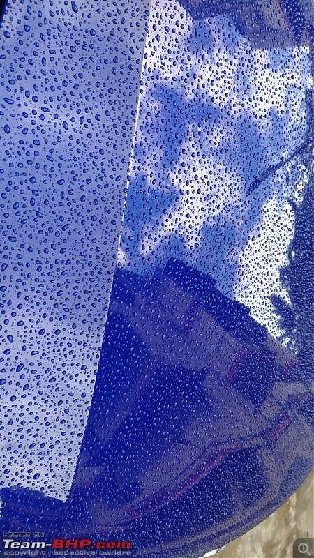

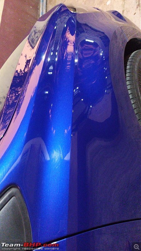

I went ahead and bought Collinite 845, and other products from Greenzcare, the package came properly and there was no damage. The guy named Hari called me to confirm the order over email and he gave assurance of proper delivery.
Now the weekend story, with all products in hand, I had a first ever detailing.
Products used are as follows.
Wash - 3M car shampoo
Clay - Gyeon Q2M Clay
Clay Lube - Optimum No Rise
Wax - Collinite 845
Overall it was pleasant experience, since the car is 10 months old and odo reading of 6K, car didn't have much paint contamination.
I tried best to follow the guidelines/videos but I think I was bit quick to buff off the wax before it was dried, I wasn't ware of the finger swipe test and later realised I hope its a long journey and lot to learn.
Sharing few pics. Appreciate your comments and tips.

Great job indeed. Please don't follow the videos on YouTube for Collinite 845. They, I noticed, use a lot of product which is unnecessary. And in my experience, applying it with foam is easier than applying it with a microfiber.
You can find more details here. I did put down the procedure that I use, in the link. You may try that way too. Might save sometime and some product.

Originally Posted by Pferdestarke View Post
Polish is good for removing very superficial paint defects and minor swirls. Also, the final output depends on a lot of factor
Thanks for the reply. Today tried to polish and wax the remaining panels. Started polishing with a perfect weather and unpredictably rain played a spoilt sport. Could finish the polishing however to just about 75% of my satisfaction. The surface especially the roof wasn't completely dry when I polished it. Hopefully it is true that Polish (Meguiars Ultimate Polish) does not need curing time. Could not wax and the car is parked uncovered under the rains
Will use a mild waterless wash by Wavex and wipe dry the car tomorrow. If weather permits, will wax the car properly. Hopefully all the hard work in hand polishing the car hasn't gone completely waste.
Good job there mate! Polishes don't need curing time, they need working time. Curing time is for LSP products.
Will use a mild waterless wash and wipe dry the car tomorrow. If weather permits, will wax the car properly.
I would suggest you to do panel wipe with 12% IPA or even better if done with CarPro Eraser.
This step removes residual polishing oils from the paint so that LSP binds well to the clear coat.
