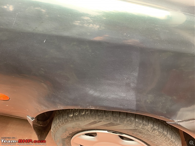

Hello everyone!
Would really appreciate some help. I had left my car out on the road just for a SINGLE day and this happened.
An imbecile with a Swift Dzire taxi was trying to paint his LHS door (which was essentially made out of body filler) right next to my car. As a result, a lot of white paint has got deposited on my cars fender and bonnet. I sent it to this FNG where they tried to polish it, but to no avail. Do I have to get these panels repainted or is there a better solution?

Did they attempt to polish the entire area with a polishing machine? No direct experience, but to my mind, that would be a very bad approach to removing spots.
I would think, and this is just an idea, that the answer is painstaking and ultra-careful removal of each spot and spec with a razor blade. If done with enough care, there should be little harm done to the underlying surface, which can then be polished.
I did this once with a spot on a pair of spectacle. I was absolutely successful. Would I like to repeat same numerous times, whoa, no! But if there is no alternative one would have to.
I'd say, try a specialist detailer. They may have tricks, or at least, a practised, steady hand.

Hi there. Here's a video on how to restore vandalised paint.
