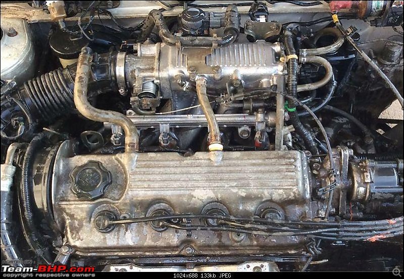

Additionally, I had done the engine "dressing" about 3 or 4 years ago. This coating or "dressing" is now peeling off in places and looking really bad. 3M say they cannot do anything about it and that putting on another coat will make it look worse.
Unfortunately this engine dressing is nothing but a coat of lacquer which eventually wears out, and starts looking horrible. Having seen it in some cars, I don't think anything can be done to it. You can try steam cleaning to remove it, but be careful with electronics and rubber parts.
This is how it looks when it's newly done
A superb Car cleaning, polishing & detailing guide-20819528_1623644714325794_3837467290936162312_o.jpg
This is how it looks after some years.
This is the sort of thing that it is all too easy to be sold. especially when having stuff done to a new car where we want everything to remain looking new. I think I might have had it done to my new Polo, not sure. Anyway, nothing so bad happened. But I did not keep that car for as many years as I would have liked, due to the flood.
Thanks, I've made a mental note to avoid this sort of treatment in the future. What good is a shiny engine anyway? I only even look at mine when I have to check or fill up something.... And then I usually realise that I have to give it a good dusting while I'm there.

I've seen the after effects of that awful lacquer coating. Gosh! It's awful, looks like a skin disease!

b) Engine dressing coats. Leoshashi's photos speak for themselves.

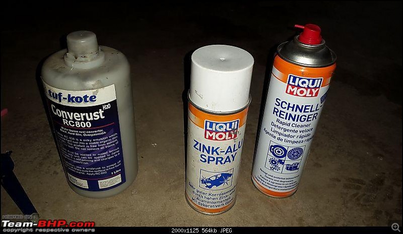

I will probably go for the rust converter as it is only a few spots which I am sure the converter can handle. Any idea which is a good brand of rust converter to buy?
I use rust converter only if I wish to prevent metal loss. For surface rust, soaking the area in vinegar works too.
I use TufKote Rust converter, works fine.
For rust proofing, I personally have these things:
In the year 2007, when I was still a Class 9 student, I remember the SA at Maruti dealership really pushing for this engine lacquer. They were showing a newly done WagonR, and it was looking truly impressive. Dad was strictly against these things, but I also requested him. Luckily a Zen owner standing behind us in queue overheard us, and showed us how it had cracked in his car. And that brought me back to my senses. God bless him, otherwise even my 800s engine bay would be looking like a skin disease today.

I have ordered a small bottle of the Tufkote Converust 800 from Amazon.
Your pics of the "Before" and "After" engine bay were absolutely spot on. Looks great when freshly applied but like eczema of the engine bay after a couple of years.
