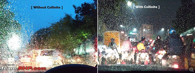

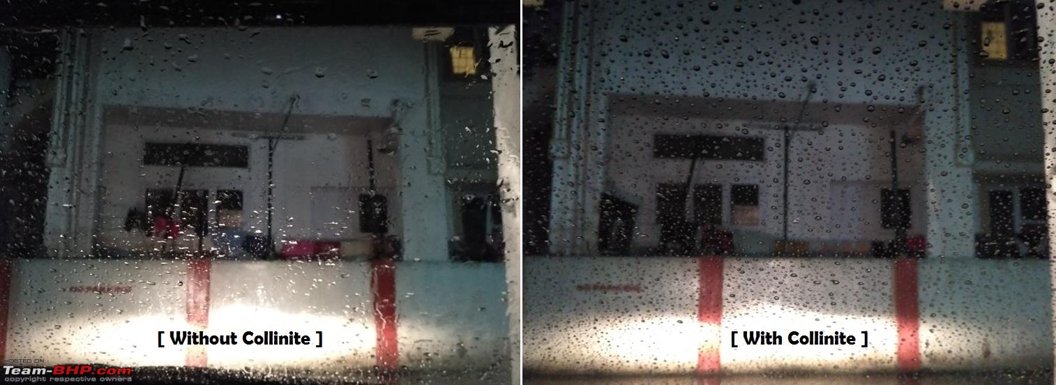

Experiment - Collinite 845 for windshield and windows:
During the recent rains, I noticed that my wiper was struggling to move around, and also the pattern of water droplets was not uniform and hence making driving at nights a tough task. While being stuck in the traffic last evening, with water clouding the windscreen, I was wondering if I could use Collinite 845 on the windshield too.
I got home and immediately did some googling and found nobody had reported issues with this application of Collinite 845, and started working on the windscreen too. This morning, on the way to office, I noticed that the water beads far more efficiently now, but the wiper still struggles. I feel it struggles even more than it was struggling earlier - maybe improper application on my part to be blamed?

Old 3rd November 2017, 08:43   #10295
Join Date: Jun 2012
Location: BengaLuru
Posts: 5,956
Thanked: 21,238 Times
Re: A superb Car cleaning, polishing & detailing guide
I have used Collinite for the side and rear glasses of my cars, my helmet visor and yes it indeed works well in the rain. I can see the ORVMs when it is dark better than when not using the wax since the water beads well and the remaining water droplets form small circles in between which we can view the surroundings more clearly. However, with the windshield, though I have tried it, I am unsure of its longevity or any other coating since the wiper action is quite pressurized and the windshield washer fluid will contain detergents. Hence, this will wear out any coating within no time and hence no such coating has lasted me long. Best is to use a nice windshield washer additive like Sonax or such which will give you good results, especially in keeping the wiper blades in good shape. In contrast, Collinite stays for a longer time on my Helmet visor since I rarely wipe it hard, except for some dusting and a gentle wipe with a damp microfiber.

Old 3rd November 2017, 18:10   #10296
aravind.anand's Avatar
Location: BLR <-> CBE
Posts: 2,135
Thanked: 6,004 Times
Pictures of the above experiment... As I had mentioned already, the water beads beautifully now, and the glass also feels smoother to run a finger through than earlier. But peculiarly, the wiper still seems to struggle!
I would not suggest using collinite or any other wax / sealant on the windshield.
Please use some hydrophopic coating, after polishing your windshield with the right tools & polishes.
Also, old wipers shall judder no matter what.
blackasta is offline   (3) Thanks
I definitely do understand and admit that fact. But what is very intriguing is that the juddering has increased a lot after the Collinite application
