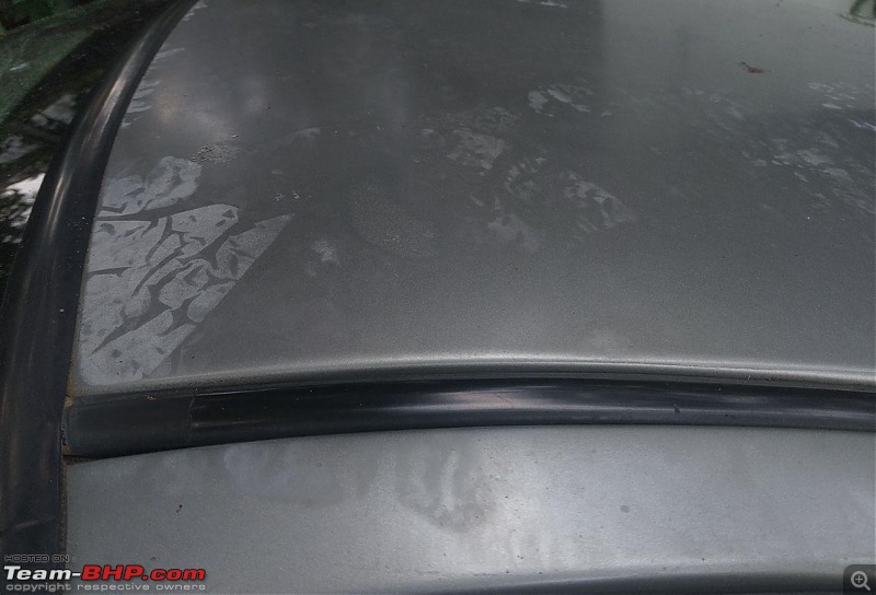

Now I have a similar, yet different issue. I was stuck with my car (2007 Fiat Palio Stile) at home because of the lockdown. The place where I work has shelter for cars but there is no car shed at home.
Since there was no cover for the car, I created one using single use soft plastic that is used to cover refrigerators. The car is parked in the open with this cover on.
Initially I saw some mold/fungus as white patches on the outside (not the interiors ), after a couple of days of a rain. I tried to remove them using Vinegar as seen in a suggestion on the web, to no avail. Now the summer showers have become regular since last week and these patches have grown a lot (Pictures attached). I am starting to worry about it now. What could be the reason for this? Is it fungus?
And more importantly, how can I remove them? Will dettol help?
I won't be able to buy any specific product online or consult a mechanic until the Covid-19 related travel restrictions are lifted.
I think it is not fungus, but some of the volatile stuff from your plastic cover. You could try rubbing with IPA or Acetone to see if it will dissolve the stain. Make sure you don't allow the IPA or acetone to touch anything other than the glass of the windshield. Try on a small area first, even if it does remove the stain, don't do all the areas - wait and check if it causes glare at night when you look out from inside the car. If it causes glare, be very cautious and better take help from an expert. The solvent will spread the volatile substance all over the windshield and cause visibility problems. You may need to use a lot of acetone/IPA and effort to remove it completely, so beware.
I don't think Vinegar is not a good option. Did you try using cleaner wax ? I got similar issue on my Pulsar 150 after a long monsoon season. Used Motomax rubbing compound ( with a dab of cheap wax) & it helped remove these encrustation fairly easy. All manual with elbow wax, no orb machines. But then had to renew the surface with multiple layers of sealant wax combo (Collinite 845 + Menzerna sealant ).
That isn't mold, that appears to some chemical leached onto the paint, and you'll need a good polish or more likely rubbing compound to remove it, as it seems to be more like glass etching than a surface stain.

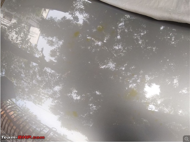

Has any of TBHPians here been successful in removing Haldi (turmeric) marks on your car or bikes paint etc ?
P.S. This is the byproduct of Avian visitors at my home.
