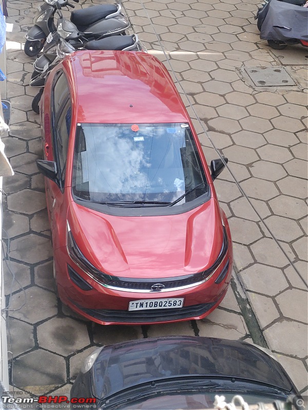

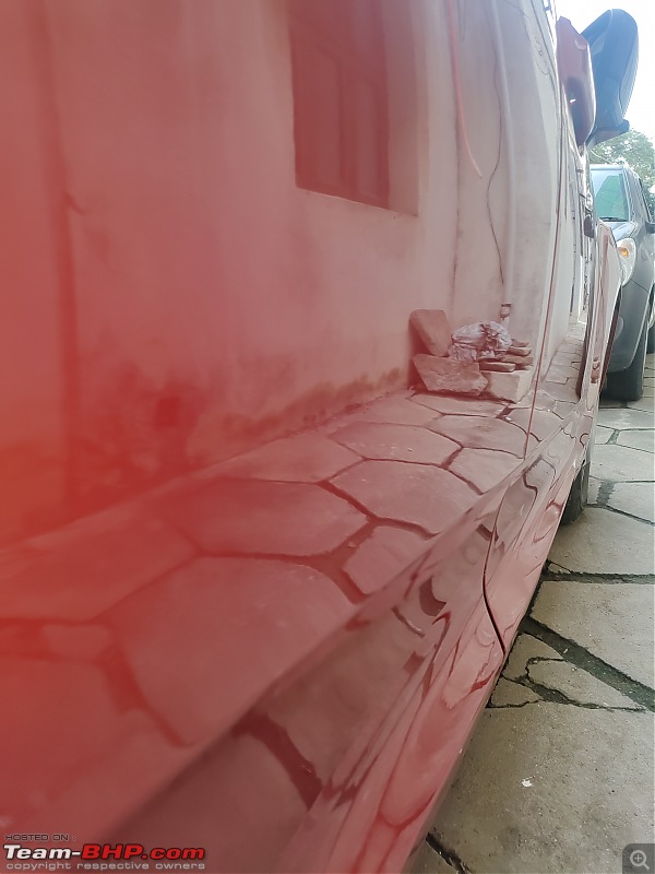

I have tried detailing my car using Amway silicone glaze and Waxpol hard wax.
First I washed the car using the 2 bucket method and clayed the car. Then I applied silicon glaze and after drying it out I added Waxpol hard wax. It was a tiring job, especially for a person who is detailing his car for the first time.

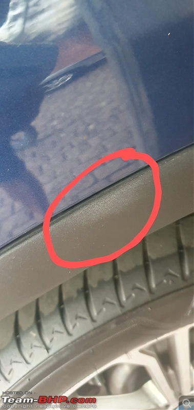

I had given my car for polishing and seems the detailing guys didn't mask the plastic trim properly and left the rubbing marks all over on the plastic trim They tried to fix it once but it came off in a single car wash. Any idea if there is any permanent fix for this?

Very common, masking tape needs to be used more often in the industry. Makes cleanup much easier as well.

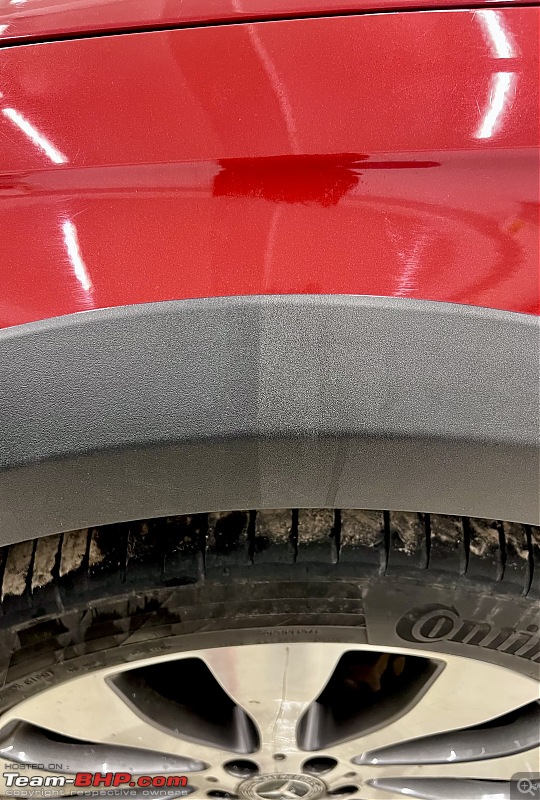

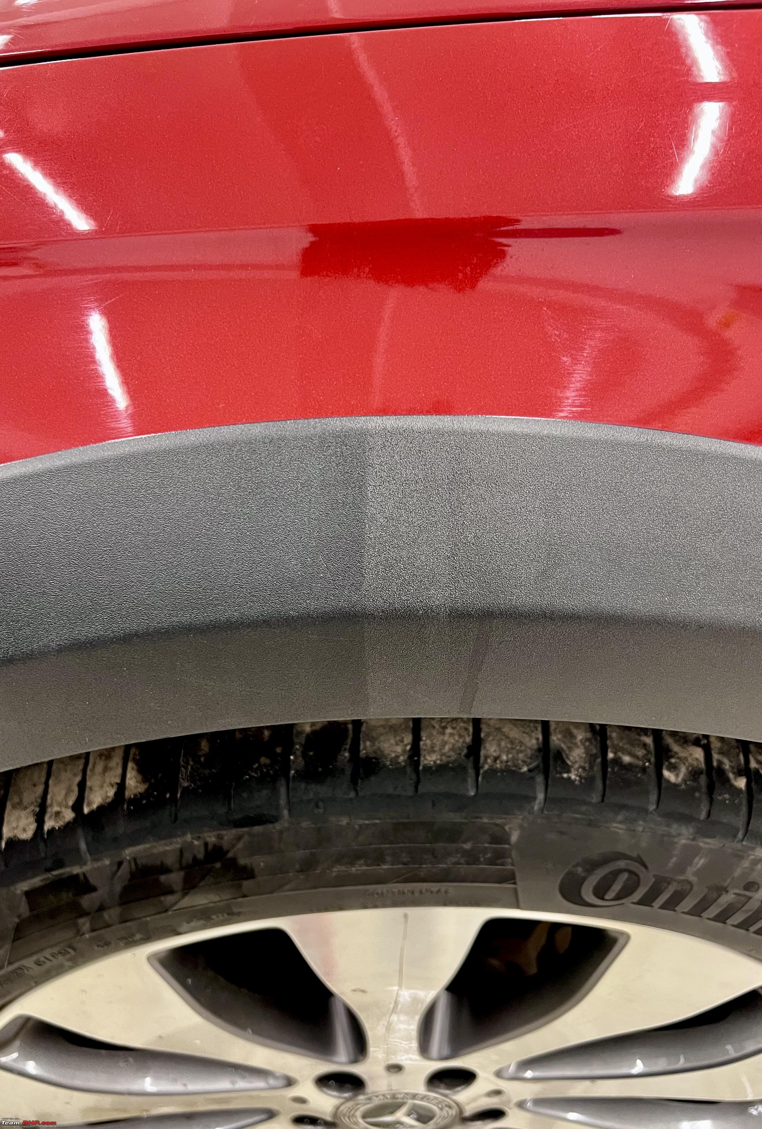

The reason it’s showing up after the wash is due to trim dressing being applied without actually cleaning the plastic first. Washing removes the plastic dressing and the white residue is visible again.
1) First mask off the painted section near the affected area, you don’t want to hit it with the brush.
2) Wipe the plastic trim with a damp microfibre to remove dust.
3) Take any APC (all purpose cleaner) like Carpro MultiX and use a detailing brush to agitate the affected areas of the trim. You might have to do this 2 or 3 times to get it clean completely.
4) Use diluted car shampoo or rinse with water to neutralise the APC. Wait for the water to dry fully, you should not see any white residue now, if you do repeat step 3.
5) Apply trim dressing of choice, Carpro PERL works very well.
Images below show contaminated plastic trim (right) and plastic trim after cleaning (left). Second image shows what it looks like post trim dressing.

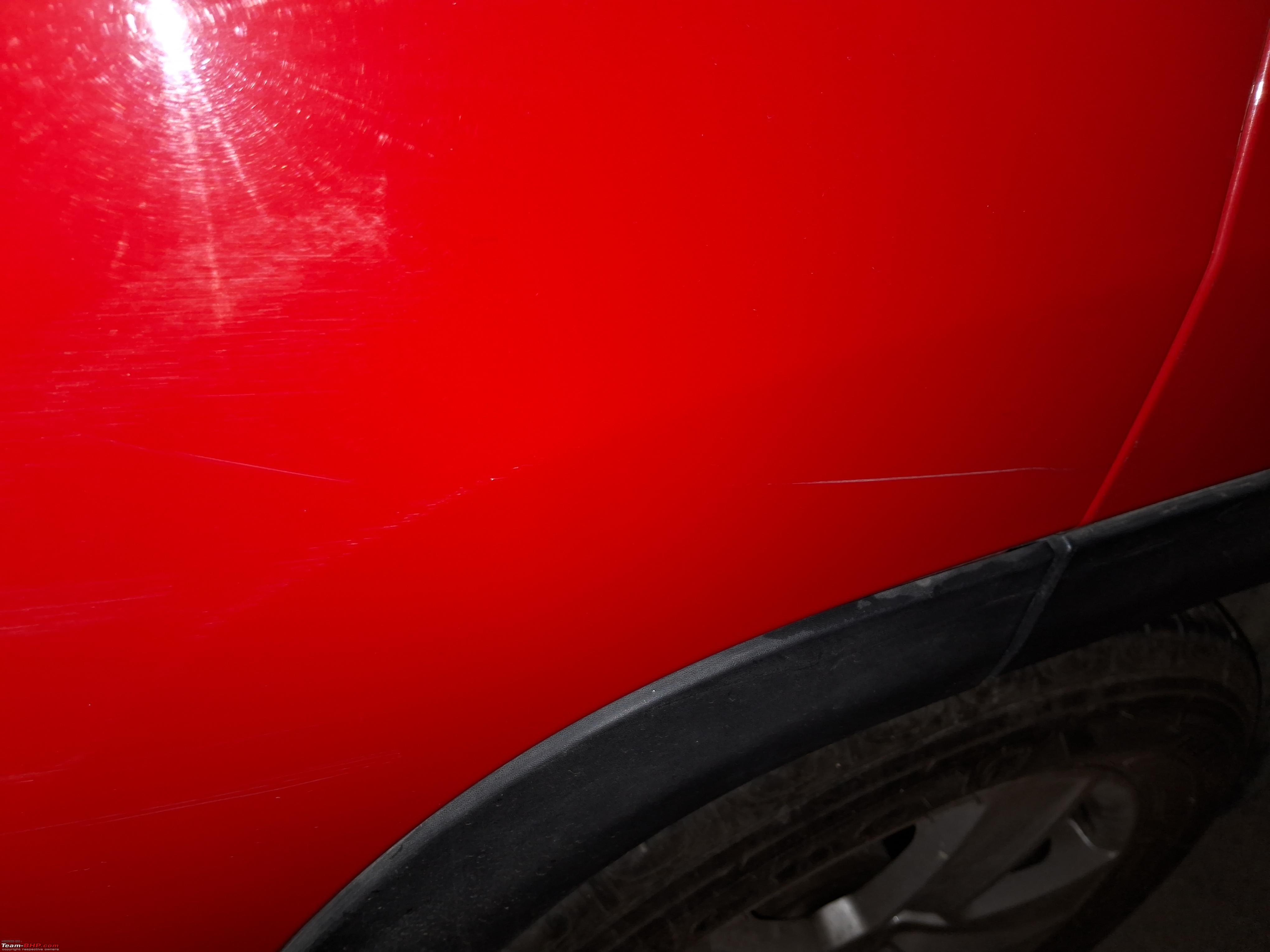

My car has amassed a lot of battle scars in the 2 years of ownership (kids at the apartment showing off their prowess in squeezing through narrow spaces, preparing for the future real-world traffic conditions) .
Their handiwork:
About the battle scars, any advice if there are simple ways to minimize the scratches on the car rather than paining the doors? I am not too keen in repainting, as I am worried about how long it would take, the painting quality and if it would match with the original. And what's the use of repainting, if I continue getting scratches post painting as well. So, do not want to spend too much on this...
Was thinking off TurtleWaxColor Magic and cover the scratches with a coat and finish up with a ceramic polish... Would this help? Any other simple DIY that I can do? Please advise
For my last car, got a lacquer pen for similar scratches - it needs a steady hand, but despite that, the results were not good

In your specific case PPF would help, but since that won’t actually stop the kids, you’ll be stuck in an endless loop of having it redone every time they tear and scratch it.
Lacquer pens are useless and make the area look worse actually, steady hand or not. There is no easy fix for bodywork and repainting.
Take it to a detailer with a DFT paint thickness gauge and tell him he’s free to use abrasives until about 6-7 microns are removed, no more than that. This should be enough to address 90% of the damage you’ve clicked above.
Hand polishing yourself yields subpar results and takes very long to do even half as well as with a machine. You could buy a machine but it takes some time before one is proficient enough to cut and finish down paint properly.
Finally, to protect use a spray on coating like Gyeon CanCoat. Will last many months.
