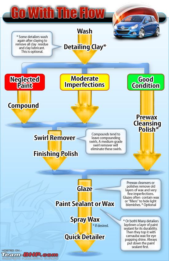

[*] For the once-a-month cleaning, I read about applying wax or sealant, plus shampoo etc. Honestly, I'm a little confused, so if someone can help break down the items I need, that'll be great.
Shampoo is for cleaning your car - removing oils and other decontaminants. I'm sure you know what shampoo is. Regarding wax or sealant - wax is just a layer which enhances your paint's gloss and helps preserve the clear coat. It is non-abrasive means it does not remove light scratches or anything on your paint. Simply enhances it and protects it.
Sealant on the other hand is applied before wax is applied and it's main purpose is to protect paint. Main difference is that sealant lasts much more than wax. Good wax lasts about 4-5 months in our conditions and it varies how your keep your car, how you wash it, covered/uncovered parking etc.
Another thing is wax is much more glossy than sealant. So, people usually apply sealant first and then wax it. Here is the simplified version:
Source: Autogeek
Depends on the product, plenty of sealants are as glossy as pure carnauba waxes, but the type of lustre is different, waxes are slightly ‘warmer’ in their gloss.
Wasn’t expecting such obvious errors from Autogeek, no mention of IPA/panel prep before applying the sealant, no mention of chemical decon with tar/ferrous removers and to top it all, tells us it’s optional to apply a glaze full of fillers right after paint correction before laying down a sealant..
