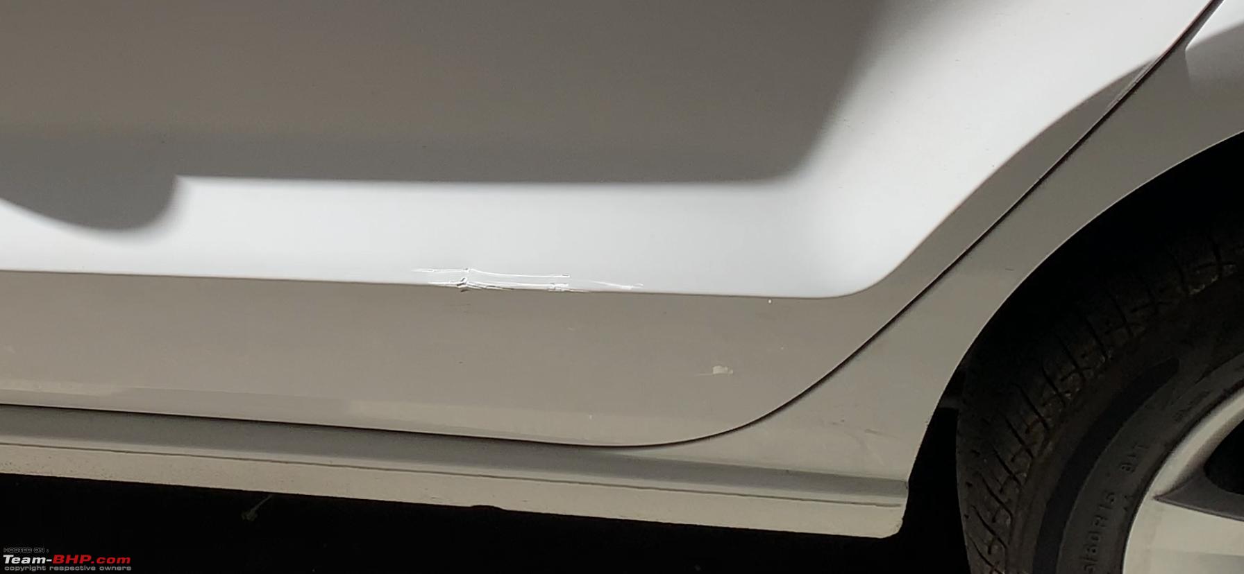

any bare-metal area caused by scratches or dings, on any car, will rust if not attended to promptly.
Hi,
Do you think I need to address the below scratch on my car which happened recently, to avoid rusting in future?
A superb Car cleaning, polishing & detailing guide-9b2723e4c2ae474689f426bbbb1581c5.png
A superb Car cleaning, polishing & detailing guide-814700b5459145e79aa97ad7d57ff46a.png
Also, a question to people owning a Skoda, how much does it cost to get it done at Skoda Service?
Thank you,
Neo

Can't be sure, but looks like you may be through to the metal. It would really restore the looks, of course if you get it fixed!
For VW, a couple of years back, I was paying 7k per panel for denting and painting. No dent? About half that. A year a go, I paid the same, 7k, to my local respected FNG
Thank you so much for your quick response. I will ask around with any FNG & Skoda ASS & get it fixed soon.
Honestly, 3-4k doesn't sound too bad if it can restore to factory quality.
Previously I got my bumpers touched up (filled in putty, sanding & two coats of paint, missed clear coat), which charged me ₹1,000. But as this is a rear left door which is metal, this would need a clear coat to not stand out, so I gotta look at other places rather than that particular FNG.
Does anyone from Hyderabad here, know any reputed FNGs who can do a neat job? I mean do the clear coat, concentrate the area with high temp, then wet sanding, the works? Would highly appreciate it.
Thank you,
Neo
