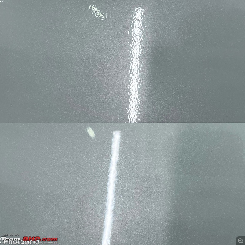

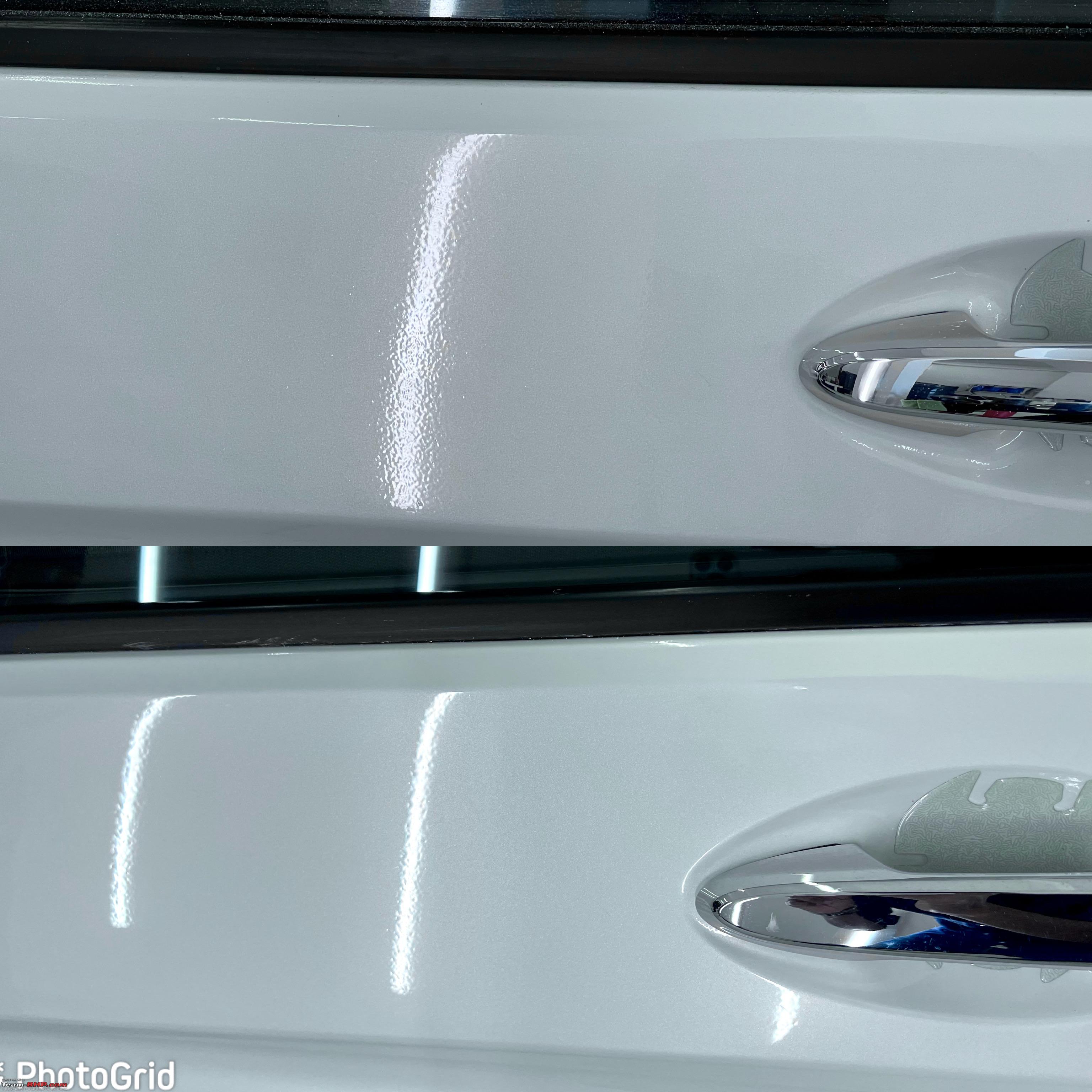

All mass produced factory paint jobs will have orange peel. Some are much worse than others, in particular stay away from Tata, Mahindra, Hyundai and Jeep (specially Compass) if you’re concerned about excessive orange peel as cars from these mfg’s have the worst peel/distortion.
To reduce orange peel significantly one needs to wetsand with 1200-1500 grit and up to level the texture in the clearcoat, this removes 12-18 microns of paint and is generally not recommended on factory paintwork as it’s quite thin to begin with (due to cost cutting).
Using medium rubbing compounds one can still achieve a 25-30% improvement without impacting paint thickness in any significant way (2-3 microns removed at best). I’ve worked on hundreds of brand new cars and irrespective of brand/mfg, I’ve yet to see one that looked perfect or didn’t require a light finishing polish by machine to remove light swirls/marring. Anybody that tells you a car leaves the factory perfect is either not being entirely honest or is simply inexperienced. Cheers.
Here’s a before and after shot of a panel showing reduction in peel after wetsanding and machine polishing. Our aim was to match the factory orange peel on the repainted door as the body shop had not finished properly.
