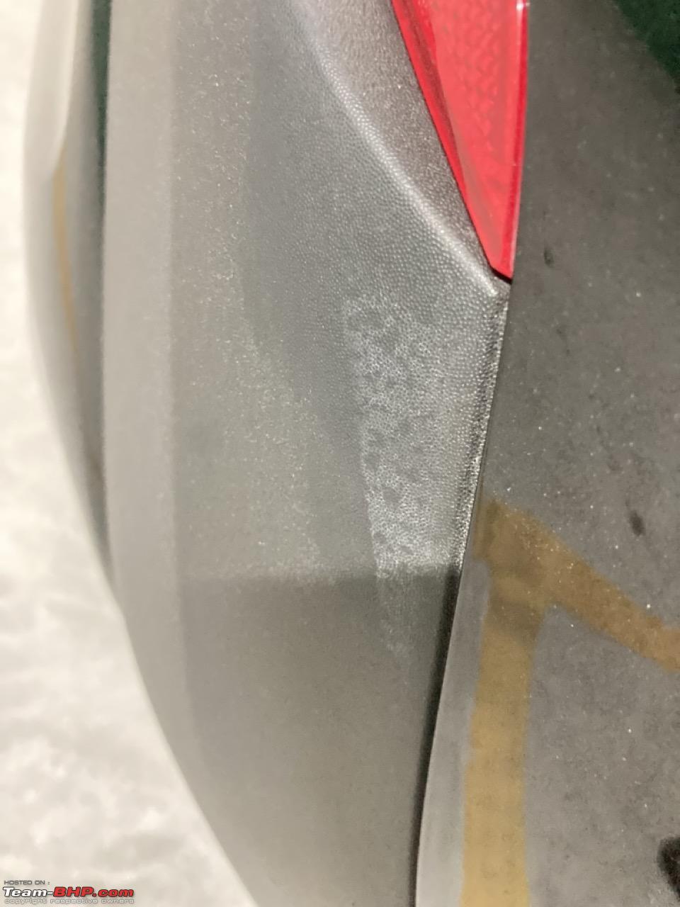

Re: A superb Car cleaning, polishing & detailing guide
Don't even know where this came from¿
Any idea if it could be corrected in any way?
Attachment 2570205
Yes, about 70-80% can be buffed out. The deeper scuffs might still show at certain angles but won’t be white like they are currently. A simple check is to wet the area, if the scuffs disappear, they’re in the clearcoat, if still visible they are through the clear (water temporarily fills in scratches in the clear.)
Use heavy cut compound with a hard foam/wool pad or wetsand with 2000 grit. 3D ACA 500 or Menzerna 400, either compound will work well. Refine with Menzerna 3000 or equivalent with a soft foam pad and apply your wax/sealant to protect.

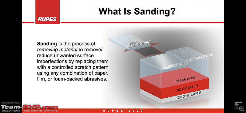

Originally Posted by McQueen View Post
This thread caught my attention. I don't know much about detailing. I request a kind soul to answer my queries.
  1. If a car is polished or waxed recently, what should be a cleaning routine? Is regular dusting allowed? Won't cleaning it with water once a week and car shampoo every alternate week remove the polish (and the wax)?
  2. If certain parts of a car are mildly abraded due to repeated touch (say near the door sill trims or the door handles), how should that be sanded/buffed/compounded/polished/waxed so it stays for as long as the original paint does? Does it have an effect similar to re-painting?
1) Contactless dusting with a powerful leaf blower is fine, cleaning with just water is also fine provided you don’t touch the paint (use a pressure washer or garden hose).
If you want to do a contact wash, use a good quality foam shampoo in a foam cannon attached or to your pressure washer. If not, use soft water in a bucket and mix shampoo in and wipe the paint with 5-6 wash mitts, using one side per panel and switching to a fresh side every time.
Do not rinse the mitts, use a fresh mitt once both sides are used. This method is called the multi mitt method and is the safest method to wash your car without inflicting swirls. Safer than 2 bucket method and eliminates the need for a second bucket or grit guards.
Note: spend as long as you want thoroughly rinsing the paint with water until you’re sure you’ve removed 90-95% of the contamination, only then proceed to the contact step of washing with shampoo.
Also, if using only water, do not wipe the paint after rinsing as water is not a good lubricant (it’s a solvent).
Use a leaf blower to dry, you will need to wipe the glasses down but the rest of body can be dried using air, if it’s ceramic coated, this takes under 5 mins and is much safer than towel drying. If you must use a towel, only dab on the surface, do not wipe.
(If you’re not doing the shampoo/contact step, you will see a very fine layer of road film still stuck on the paint even after through rinsing with water and drying with the blower, this is normal, do not try to wipe off as you again risk swirling.)
Regular cleaning is healthy for the paint and any paint protection you have applied as contaminants cannot build up on the surface, waxes and sealants (and coatings) will last the longest when washed safely using a gently pH-neutral shampoo and soft water.
Only exception being right after you’ve applied the wax/sealant/coating. With ceramics, do not wash for the next 7 days, with waxes and sealants read the bottle label. If not mentioned, wait 48hrs before exposing to water and you’ll be fine.
2) How to fix:
- Clean area with all purpose cleaner/diluted car shampoo
- Clay area are to be polished
- Use a heavy cut compound like Menzerna 400/3D ACA paired with a heavy cut pad
- Refine with a fine cut polish like Menzerna 3000 paired with a soft cut pad
- 25% IPA wipe polished area
- Apply your wax/sealant
(If door sills have any glue reside, first use a glue remover to clean before doing the clay and other steps.)
Polishing paint to remove defects is not the same as repainting. Here only a small top layer of clearcoat is removed to level off the scratches and restore gloss and clarity to the paint. When we repaint, we’re removing all the layers of the paint right down to the metal and applying fresh primer/base/clearcoat. See graphic below illustrating paint correction via polishing-

I noticed white patches on my car's cladding after the ceramic top-up a few months ago. I tried to clean them up with a brush, but they're not going away. When I went to a car wash last week, they told me it could be the polishing compound.
Any idea how it can be cleaned up?
Appears to be polishing residue from the detailing shop, owing to improper masking of the plastic trims.
Clean the area with diluted shampoo and water, apply an all purpose cleaner (APC) like Carpro MultiX with a detailing brush using light pressure. Rinse off APC with water, repeat if necessary.
Protect the plastics with any good plastic trim dressing, like Carpro PERL.
