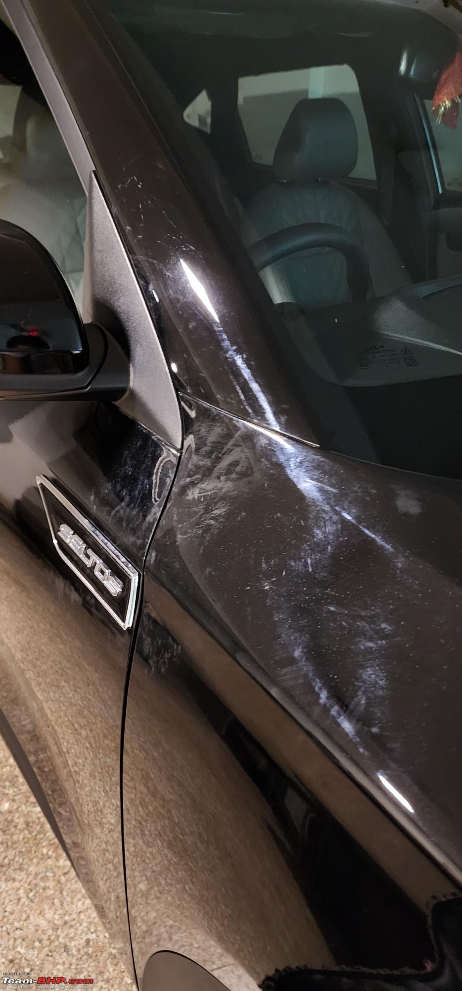

Bad Experience with Detailing Bull
Want to share a recent (bad) experience with one of the Detailing Bull outlets in Delhi. This one is located inside the Pacific Mall, Shubash Nagar. Our newly purchased Seltos black Xline has many swirl marks and minor scratches that we received from the showroom. So we wanted to do an initial round of detailing to remove the paint imperfections, and have some extra gloss added to the paint work - that's what the detailing package mentions which also consists of a steam wash (oh btw, there is no actual steam wash available with the detailer, just a regular shampoo wash which they conveniently call a steam wash). But instead, the detailing folks have left these stubborn smudges which just won't go. See pictures.
This one shows the full wrath of it:
The smudges are on the glass area as well:
On the door handle:
And some more:
So my son took it back to the detailer who inspected the car and mentioned a good wash and some wax afterwards would take care of it. Now the funny thing is, the smudges don't appear immediately after the detailing. It's only after a few hours (with no washing or any cleaning involved), that these smudges would start showing up. And that's exactly what happened this time too.
This is how the car looked immediately after the wash (no smudges anywhere):
Checked the car in the parking area next day and found the same smudges all over. We are not sure what to do next. Definitely not taking it to the same detailer as he clearly has no idea what's going on. We sent him the pictures again and politely told him that we wont take the car to him anymore and he happily chose to oblige without making any efforts to fix it or gain our confidence. Not that we wanted him to do anything anymore, but very poor service standards.
Experts - any advice on how to address this would be greatly appreciated, thank you.

It’s very difficult going by pictures alone but it’s possibly dried paint sealant/wax applied in a hurry and not levelled properly. Are you able to wipe away the smudges with a light finger swipe temporarily before they reappear? If yes then it could also be very low quality wax applied in patches to which dust is adhering.
I doubt he’s done any machine polishing as I can see the swirls clearly in the after shots. If it is indeed dried sealant/wax residue, lightly polishing with a fine cut abrasive will strip it completely (Menzerna 3000 for eg.). This can be done by hand but it’ll take a lot of time, much better done with a soft foam pad and a polisher.

Thank you for your response. Yes, it does seem like a bad job done without giving it enough time.
You're right - the smudges go away with a light swipe (with fingers and microfiber clothes).
The detailer did use a rotary polisher to apply wax/other detailing products. Maybe just a shoddy job he did.
Just to confirm, is there a different polisher you are referring to or the Menzerna 3000 that you mentioned earlier?

Then it’s the type of wax used and patchy application that’s most likely the cause.
Menzerna 3000 is a fine cut polish (liquid abrasive), used to remove light swirls and defects in the paintwork.
It is applied either by hand or with a foam pad attached to a polisher (rotary or dual action depending on the person).
The good news is it will wear off by itself in a few weeks as the wax breaks down. You can wipe with 30% IPA to help speed up the process. Washing a few times with Carpro Reset (stripping shampoo) will also help in breaking down the wax sooner.
