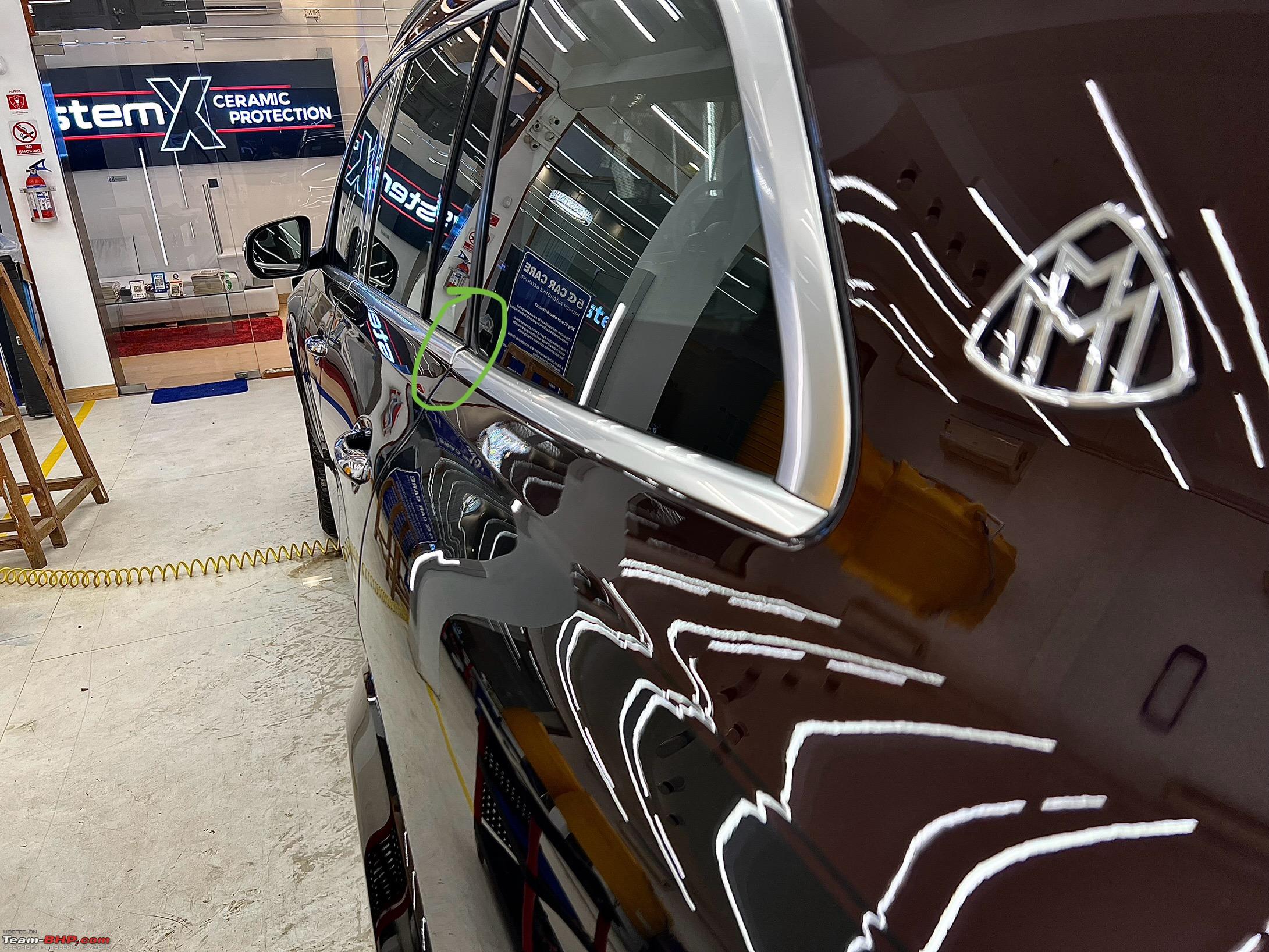

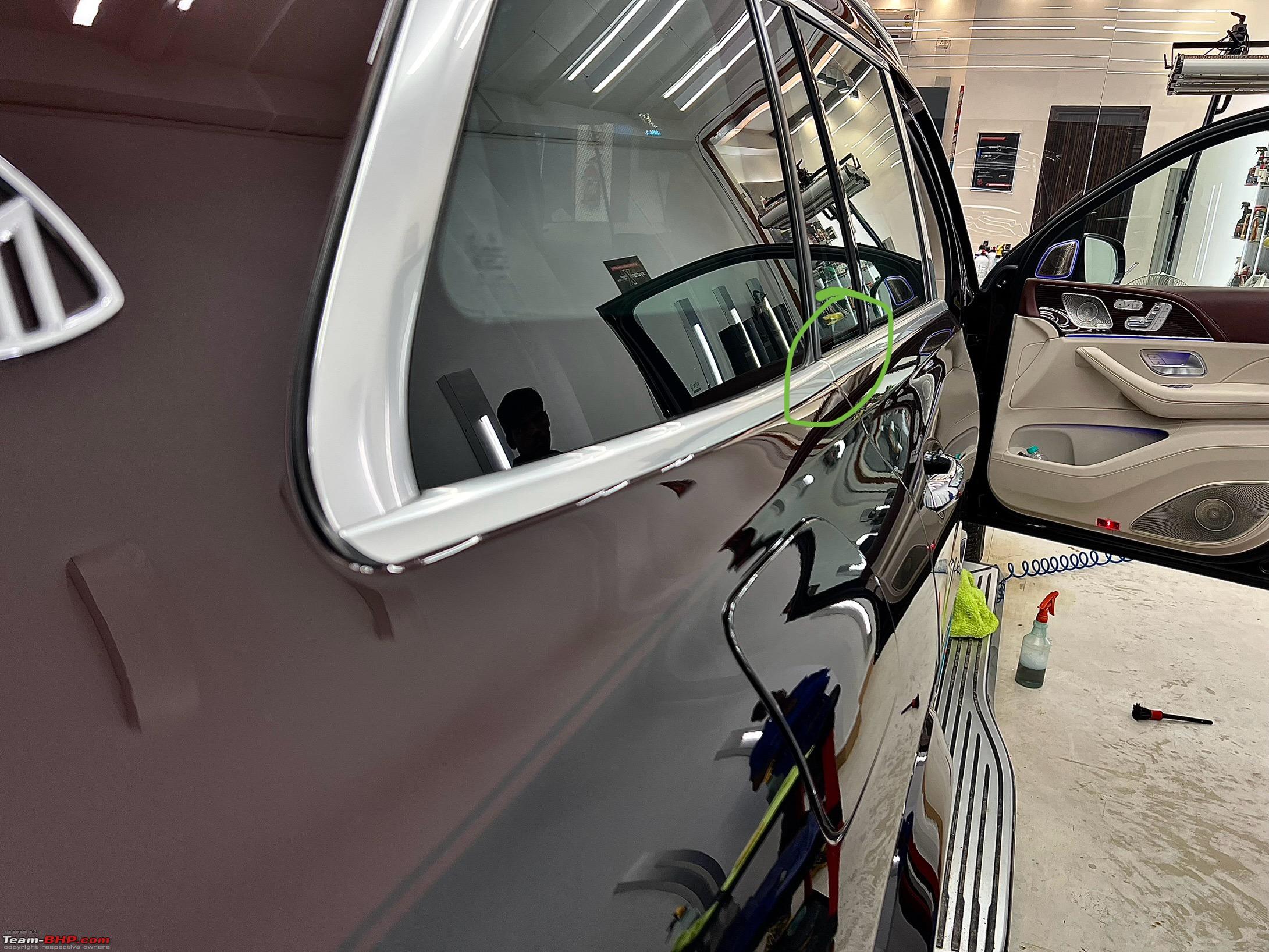

Beg to differ, there is nothing smooth with how S/Maybachs are delivered to customers. Zero difference compared to how cheaper mercs are handled and stored pre delivery by the dealers (read very poor).
As someone who works on Maybach’s fairly regularly, I can tell you the craftsmanship and paint quality is mediocre at best. Look closely and you’ll find more than one piece of debris, misaligned door trim and in certain cases even uneven panel gaps. This is true for any mass produced car, that’s why they’re so cheap compared to a hand painted Phantom for example.
For reference, see how misaligned the left rear door is on this brand new Maybach GLS 600 (right is normal):

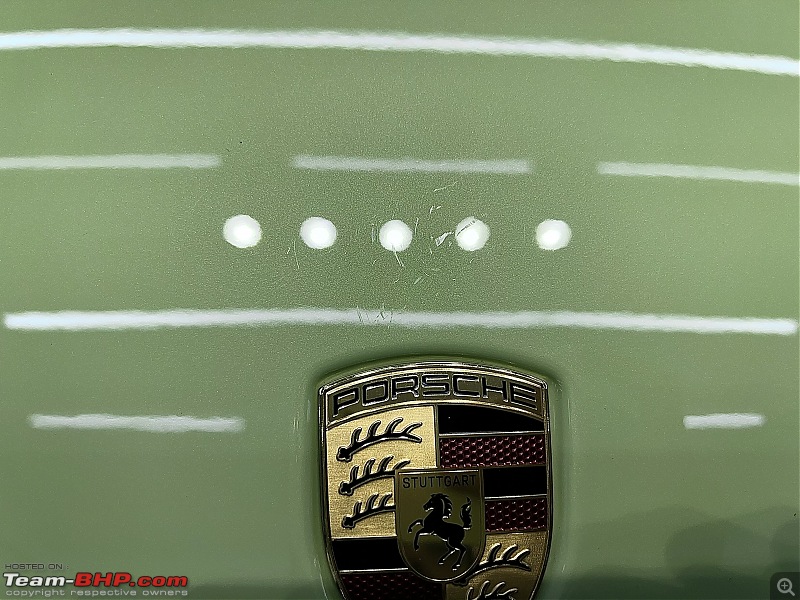

Most of the clothes used by dealerships are pretty basic even new, This causes swirl marks. It's not as if any factory will finish the paint with such marks. This has nothing to do with mass-produced or handmade. And in this age, I don't think any cars are hand-painted in the first place. Google tells me that certain models of Rolls-Royce, but I am not sure, as automated paint booths should have better results than men.
Cloths are the not issue, it’s improper washing. Majority of dealerships are completely clueless on safe washing technique, most don’t even have a foam cannon or high quality wash mitts.
Factory finish can absolutely have all sorts of such issues, from sandpaper scuffs to pinholes to fish eye to excessive orange peel to haze. I can show you well over a 100 pictures from nearly every single mfg to prove this.
It has everything to do with mass produced vs handmade. Hand painted and finished cars take well over a month (a few months normally) and run over a million dollars for pebble beach type projects (just the paint, not talking restoration, that’s extra.)
You cannot achieve perfection when mass producing anything as they just don’t have the time to chase every imperfection/piece of debris stuck in the paint at a factory. Some brands are better than others though. Many cars are still hand painted, they’re just very expensive due to all the effort involved. Automated doesn’t mean it’ll be better quality, it’s done to dramatically reduce cost and improve efficiency at the cost of quality.
Of course, the quality of paint, thickness, shine, etc., will be far superior on the expensive cars, and it does vary from brand to brand.
No, price has nothing to with spray quality or thickness. A cheap Polo is much better painted than many 2 million dollar hypercars. You’re right about the variance between brands although thickness is largely the same (100-150 microns with exceptions.)
Regarding Mercedes, the paint quality, especially on CBU models & Maybach, is top-notch. But one can do nothing if someone rubs a bad cloth. BMW has one of the worst paint thicknesses/surface finishes, amongst premium manufacturers; Porsche/ VW are relatively better, but Mercedes has the best.
Not true, merc and BMW are the exact same thickness (95-120 microns on avg.) CBU or otherwise. BMW in fact has less debris in the clearcoat than mercs do on average. Merc is strictly mediocre, doesn’t matter CBU or CKD. I’ve yet to see a well painted merc in nearly a decade of working on them.
VW used to be acceptable before the MQB-IN platform, now it’s terrible. Porsche the less said the better, they’ll put swirls and paint overspray in from the factory, even before the dealer gets his hands on it. Lexus and Volvo are somewhat better although certain newer Volvos have fallen in quality.
Toyota is still quite good, although they mess up on white colours. Honda and Suzuki are as bad/mediocre as merc. Hyundai, Tata and Mahindra (and Jeep) are the worst in the industry, it’s like getting paint done at a budget body shop with the last group.
Brand new 911, owner took delivery straight off the truck, dealer didn’t even touch it and yet you see swirls, green paint overspray on the sunroof and rear engine cover, and in general terrible quality-

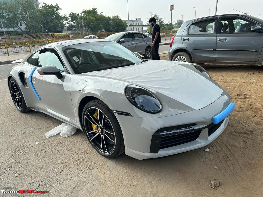

I don't know about your customer, but this is how the Porsche comes from the factory. Consider the time it spends on Port/ Ship and all the weather - rain/ dust storms etc. Cars that come in containers will surely be better protected.

4) Yes that’s how we got it as well, on a flatbed. He didn’t even want to drive it before we coated it. But look at the pictures above, none of that happened during transport as rain and dust won’t cover a car in matching paint overspray and scratches. It was all at the factory. These are well known quality issues with Porsche’s, it’s never perfect out of the plant.
You’ll be surprised to learn as I was, when you peel the white protective film, the piano black plastic already has fine swirls and a haze from the factory itself. We think the car hasn’t been touched out of a factory, whereas in reality, it has had a lot of workers and inspectors handle it and many don’t take perfect care to not inflict minor damage on the paint. Modern water-based paint is so soft, that just barely dragging your finger across or wiping with a soft face tissue is enough to leave light scratches behind.
