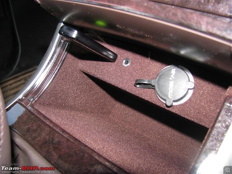

Niggle : USB port is located in such a way that pen drives stick out, prevent closing of the lid, and may get damaged too.
Solution : Use a USB cable to connect your pen drive. The lid can then be closed and the pen drive will be safe.
Thanks for the solution Debuda!
There is an alternate solution as well. There are pen drives available from HP, which are really small and you can close the lid without any issues.
