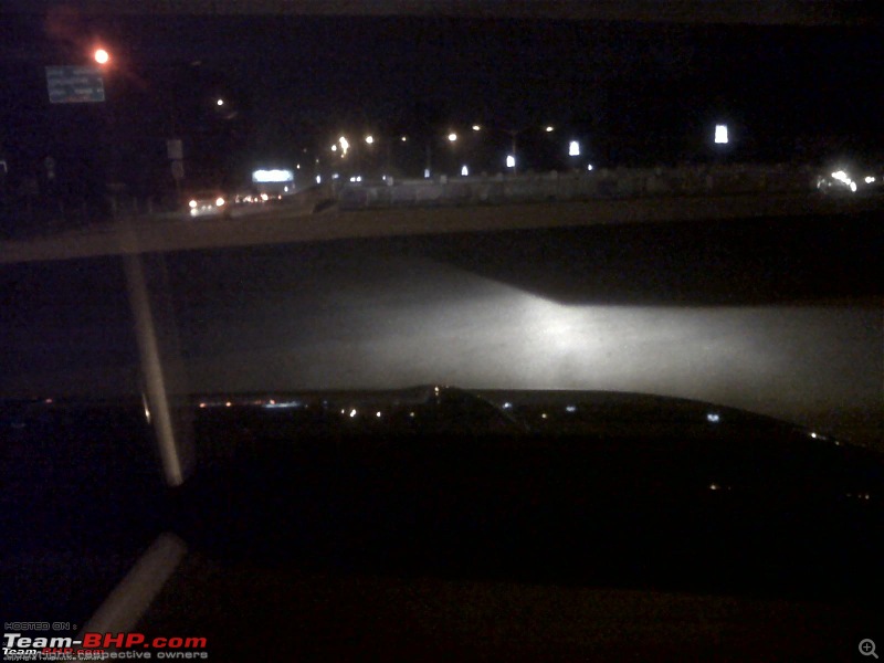

I wished I never had to post in this thread... but here I am. though not sure if this is a niggle or is there some way to correct or adjust this thing. so here it goes. the instrument cluster is not bright enough when I switch on the LED's or headlights. its no where as bright as a toyota or honda instrument cluster. infact it gets dull compared to when the LED's or headlights are off i.e. no lights are switched on. also the power window and steering mounted controls switches are not bright enough and are a bit dull and difficult to read. is there a setting to adjust this brightness like how we can adjust the lounge lighting through a switch near headlight adjustment and infotainment display brightness from the touchscreen setting option?
and also one more issue, which is a bit distracting, is there is no light on the top extreme right hand corner when the projector lamps are switched on. is this an issue and if yes what is the solution? I think this issue has been discussed earlier also but i never came across any solution or answer for this yet.
its basically a triangular dark spot from the RHS head light as reported earlier by mannubhai on the 2nd page of this thread. attaching the pic again for reference.
This is clearly by design. It helps not blinding the oncoming traffic. This kind of design is not unique to XUV5OO. I have seen it in a Innova as well as a i20 recently.

triangular dark spot solution (if u cant live with the dark spot)
Turn on the dippers on a dark empty road
Open the hood.
Just behind the right headlight you will see a white knob
Turn the knob to adjust the focus. Once you turn the white small know u will see the beam of the light going up or down. Just turn it in such a way that the light goes up and your blind spot is gone.

Some excerpts from Wikipedia on Headlights:
Low beam
Low beam (dipped beam, passing beam, meeting beam) headlamps provide a distribution of light designed to provide adequate forward and lateral illumination with limits on light directed towards the eyes of other road users, to control glare. This beam is intended for use whenever other vehicles are present ahead. The international ECE Regulations for filament headlamps[5] and for high-intensity discharge headlamps[6] specify a beam with a sharp, asymmetric cutoff preventing significant amounts of light from being cast into the eyes of drivers of preceding or oncoming cars. Control of glare is less strict in the North American SAE beam standard contained in FMVSS / CMVSS 108.
There clearly exist Automotive Regulations for Low Beam of headlights on vehicles and the asymmetrical throw is the proper design towards the same. It is better not be tampered with in accordance with regulations, traffic guidelines, traffic police actions thereof as well as hassles with manufacturers if you do tweak with it, but I feel more importantly onus on driver to respect oncoming traffic.
Also, this is not a niggle or an issue
Fully agree with SDP and Parsh. Today, I checked out my brand new XUV-W6's headlights in the night for the first time on some dark, rural roads near Jamshedpur. The dark triangle on the right hand side is quite similar to that created by my Swift's low beam. It is obviously designed for enabling better visibility for drivers of oncoming vehicles by obviating dazzle / glare. This certainly is NOT a niggle and the factory settings should not be tampered with.
Incidentally, I found both the low and high beams quite good. The static bending lights were useful as well.
