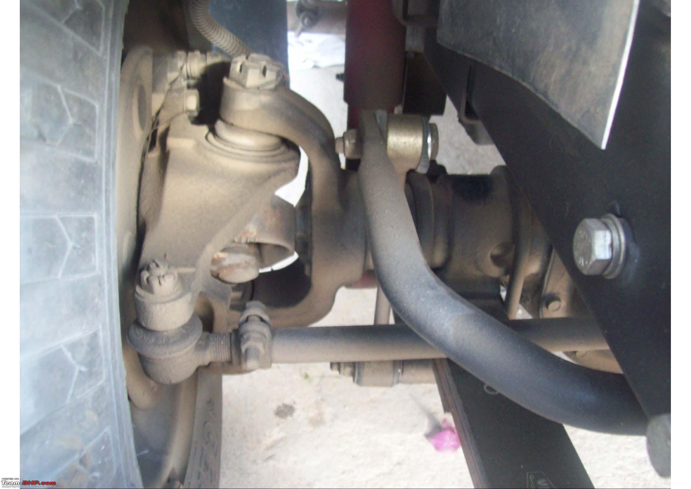

I need a little help regarding greasing of steering (Thar di 4x4).
I am attaching here snap of particular page form Parts catalogue (STEERING TIE ROD) which is showing Grease Nipple 2 Nos (FIG No. 12.Mahindra Thar : Issues & Solutions-thar-di-rhd-bsiii-2wd-4wd-ver-1-november-2010.jpg
I am also attaching the snap of Right
Mahindra Thar : Issues & Solutions-right1.jpg,
Middle
Mahindra Thar : Issues & Solutions-middle1.jpg
& Left
Mahindra Thar : Issues & Solutions-left1.jpg
from vehicle but I am not able to locate the grease nipples. Please help to find out the same.
Will it really make steering easy after greasing?
