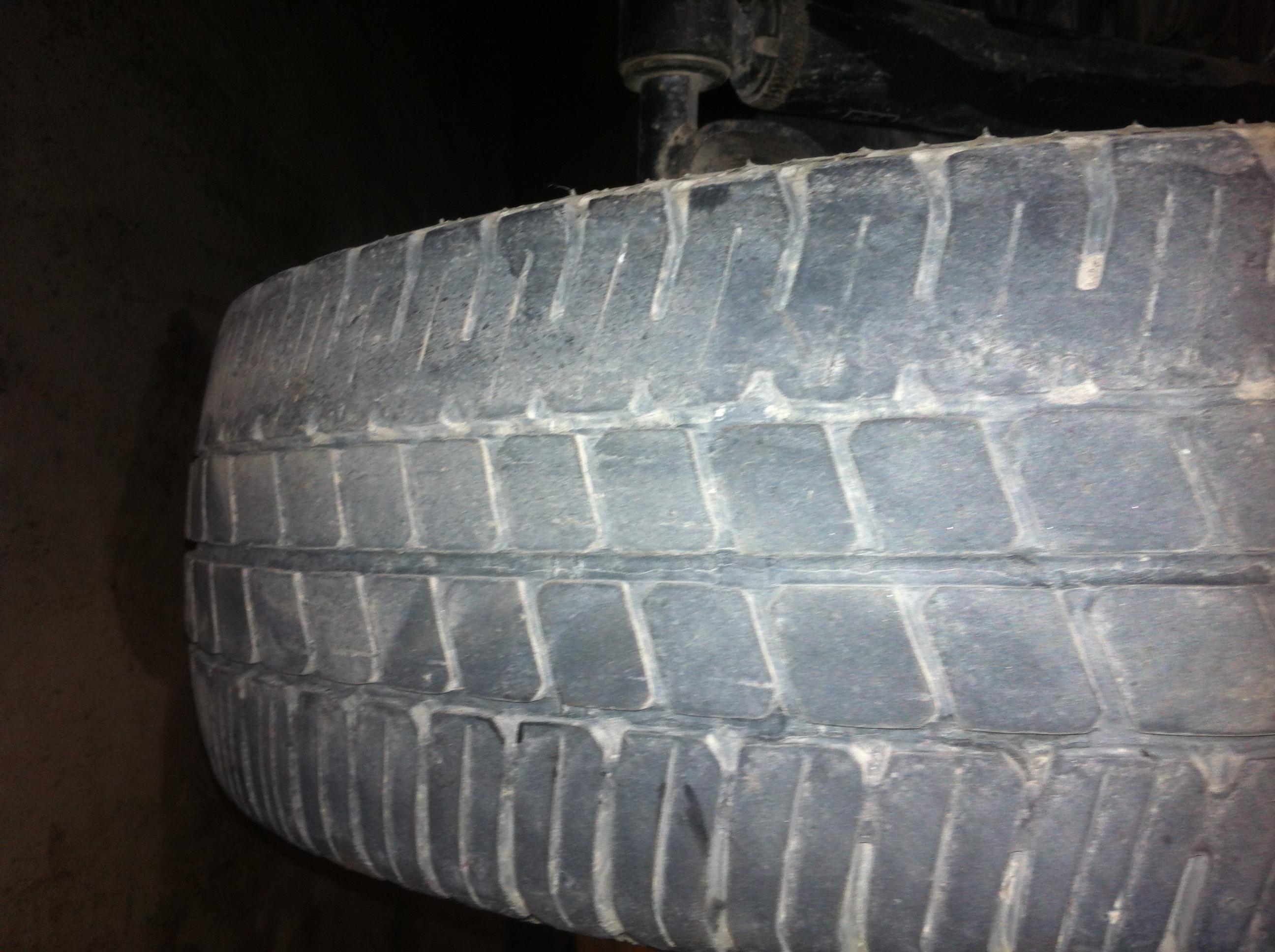

Hi all, got my Sparky checked at the service centre. They checked the car thoroughly and the service advisor informed me that he will get the suspension checked. The following were the outcome of his thorough investigations
1. The tyres had got worn out from one side
"My Car / Steering / Brake Vibrates While Driving" | What To Do-img_1654.jpg
2. Diagnosed the suspension mounts to be the main culprit. The main reason he said that due to climatic conditions and also since the vehicle was parked for long durations without any significant movement, the suspension mounts along with the suspension bearings had worn out and hence needed replacements.

The worn out mounts had also caused th front two tyres to get worn out from inside.
"My Car / Steering / Brake Vibrates While Driving" | What To Do-img_1659.jpg
