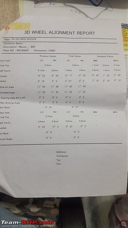

Hello all,
I own a 15 year old Maruti 800 DX 5 Speed. Recently got the brakes serviced at a dealer, somehow they messed up something and a problem arose.
Description and nature of the issue
  • Steering Vibration upon braking
  • Happens from speed 40kmph and beyond
  • No pedal or floor vibration
  • No sound from brakes or while steering vibration
  1. Check for looseness, and if required change, steering ball joints & tie-rod ends
  2. Check for free movement of steering with front end jacked up/on ramp
  3. Tighten steering rack bolts
  4. Change strut rubber kit both sides
Sir,
The previous set of troubles which I faced are completely resolved now. No steering or floor vibration upon braking. Tested them for over 1000kms.
However, today I noticed another issue when I braked hard. Let me explain.
I was at 90kmph on an empty stretch of road, when an idiot's full size helmet flew out of nowhere and was lying straight ahead of me. I had no option rather than standing on brakes and shedding speed. I slammed the brakes and held them(didn't pulsate the brake input).
Observations-
1. Initially there was no noise, say for about 2 seconds. Then a mild "Ggrrrrr" sound started which had increased to a loud humming sound by the time I had stopped.
2. No cabin vibration was felt while this humming sound came; to my ears, it was coming from front.
3. I again braked, this time gently but continuously from 90kmph and again same thing repeated. I also noticed- If steering is let loose, steering wheel doesn't turn but car has a tendency to drift towards right.
Alignment and balancing appears perfect, no issues with car pulling or vibration at speeds. It happens only during braking. Also I must mention, brake pads are new, along with front stabiliser bar bushes(changed on 9th Aug 2015).
After the brake job was done, one thing I noticed was if you stop, sometimes a very mild "Dhannn" sound comes from front, as if the brake pads are loose and moving or something is wrong. This sound wasn't there before brake pads change.
I am also attaching the latest 3D alignment report for your kind consideration-just in case if your expert eyes notice something wrong.
I have some doubts on Castor and Camber values, however mechanic said they are fine.
*Reference Values sourced from M800 Workshop Manual
"My Car / Steering / Brake Vibrates While Driving" | What To Do-capture.jpg
* Alignment report on 23rd July 2015
"My Car / Steering / Brake Vibrates While Driving" | What To Do-20150901_001835.jpg
*Latest Alignment report, done on 18th September 2015-Castor, Camber and Toe Values when seen top to bottom.
"My Car / Steering / Brake Vibrates While Driving" | What To Do-20150914_161048.jpg
Shashi
Leoshashi is offline   (4) Thanks
Old 25th September 2015, 05:07   #127
SS-Traveller's Avatar
Join Date: Jan 2009
Posts: 8,279
Thanked: 28,720 Times
Re: "My Car / Steering / Brake Vibrates While Driving" | What To Do
...a mild "Ggrrrrr" sound started which had increased
You just glazed your brake pads.
Without getting into a debate about the quality of the product you already had, I'd suggest get some good quality pads and replace the old ones.
SS-Traveller is offline   (1) Thanks

Old 26th September 2015, 01:04   #131
humyum's Avatar
Join Date: Feb 2006
Posts: 2,825
Thanked: 5,851 Times
Hey, Sashi,
The alignment readings are fine. Since you have got the pads, have you bedded them in?
Like did some multiple hard brake applications from 80-90 speeds while letting the pedal go just before the car comes to a stop otherwise the brake pad material get itched on the discs.
Get the tyre pressure checked first and try braking hard tomorrow whenever u see a no man's land stretch and see what happens. The stretch should be not banking on any side. Is the car braking properly ? is it still pulling to the left or right ?
Can you ask someone to record a video from inside the car when u brake next time if possible ? I don't think u have glazed the pads.
humyum is offline   (2) Thanks
Old 26th September 2015, 14:36   #132
Leoshashi's Avatar
Join Date: Jul 2014
Posts: 5,725
Thanked: 43,490 Times
Originally Posted by humyum View Post
Hey, Sashi,
Thanks for the reply Rohan Sir. I am now relieved that the caster and camber values are fine.
I didn't take any specific measures to bed in the brake pads, just drove naturally. The mechanic told me to be gentle with the brakes for 10 kilometers, and I ensured that. I never held the brakes after car came to a halt, since that might sometimes damage the discs also.
I keep a tyre gauge and pump everytime in my car specifically for this purpose.
I will try to do hard braking while recording a video next time I hit the empty highways. As of now, I am having no issues within city speeds. Yesterday I went till 70kmph, the brake drag was not very evident.
Still I have thought of getting the calipers overhauled anyway within a month or so. They have already done more than 2lac kms and are 16 years old.
Shashi
Leoshashi is offline   (5) Thanks
