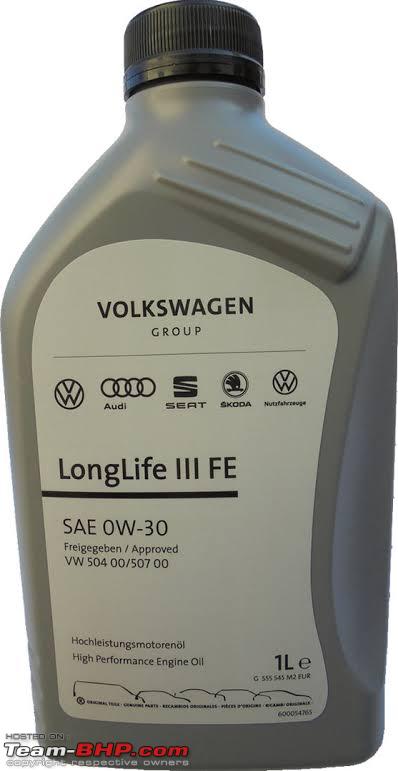

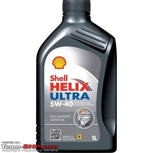

Originally Posted by sidpak View Post
I was under the impression that Skoda now has a tie up with Shell and Shell Helix Ultra is used by all service centres across the country.
Correct me if my understanding is wrong
Cheers,
Sid
VW and Skoda both have their contract on engine oil supply from Shell - a fellow BHPian who works with Shell also confirms this and the bottles are also a testament to this.
This is a global contract if I’m not mistaken.
