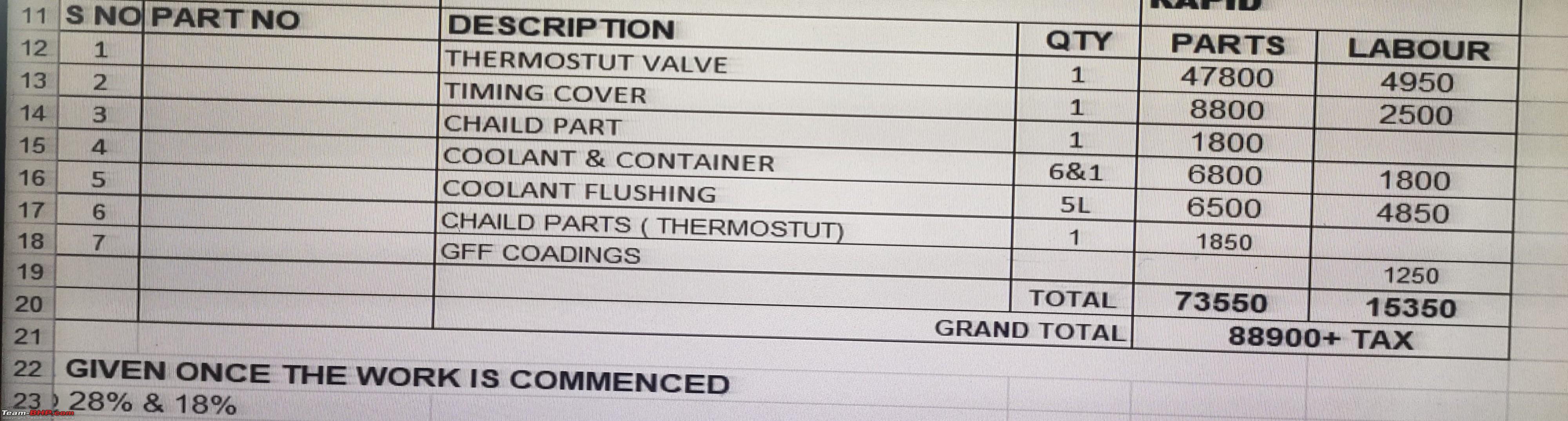

I got a prelim quote after diagnosis. It seems there is a leakage near the Thermostat. This was suspected by the FNG as well, prior to giving to Skoda ASS. They are quoting 47K for Thermostat. It sounded too expensive. Online price are all under 8K. Any idea why a thermostat could be so expensive.
Attachment 2648119
Cross-posting from another thread. 47K for a thermostat sounds exorbitant. Did anyone replace it recently? What was the approx cost?
Background: Coolant was leaking near the thermostat region.
Attachment 2648120
I have the same problem as you right now and it is yet to be diagnosed. I will have the car checked in coming days. My coolant gets exhausted only when I drive with the AC on. If I drive without the AC, it works fine. The car works fine.
However, to your query - I do not visit Skoda ASS as I bought the car used recently only as a weekend drive and as a 2nd car. I get my things fixed only at FNG. I have personally covered over 13K ever since buying the car. I was a wonderful experience until recently when I started getting issues in the car.
Quotes given by Skoda to you seem very unreasonable
Why do I see the Timing Cover there?
What Child Parts (assuming that is the correct word here) are they referring to?
Why do we have Coolant (Qty 6) and Coolant Flushing (Qty 5L in two rows?
Why is the container to be replaced? (though it doesn't seem to be very costly here)
Not to forget, if indeed you have this fixed at Skoda ASS, they for sure will open another list of items to fix/replace when they open the car.
Attachment 2648120
Whichever ASC has done this has tried to rip you off clean.
The OE Skoda water pump on boodmo costs 20k for the 1.8 TSI.
The pump for the Octavia Mk3 1.8 TSI OTOH is expensive because it has an electronic thermostat integrated with it (the entire thing is called the thermal module or something). That costs around 48k.
Aftermarket ones like Vika in fact start at 4k and even reputed ones like INA/Schaeffler won't be more than 10-12k.
Skoda Laura: Problems & solutions thread-screenshot_20240829234620610_com.android.chromeedit.jpg
Skoda Laura: Problems & solutions thread-screenshot_20240829234135390_com.android.chromeedit.jpg
There is a slim chance that part cost has gone up. However, even then, I genuinely doubt if it would have more than doubled.

Thanks sunilch and vishy76. I ran out of coolant on the way to Hyderabad from Bangalore. I reached Hyderabad by filling RO water and distilled water. Hence coolant flush is needed. I am yet to ask the SA about the timing cover, coolant tank etc., because I wanted to figure out the thermostat part first. I have asked him for the exact part number and pictures. It doesn't help that I am in a different city and they know it. It doesn't make sense to spend > 1L for a 2011 car. I am considering transporting the car to Bangalore and give to my FNG here. I hope it is an honest mistake mixing up the part numbers on their part.

Update: the part to be replaced is 06H 121 026 DS. This is the complete water pump, thermostat and some seals. Originally I thought the quoted cost is only for the thermostat. Anyway I have asked the SA if they can just replace the thermostat and plug the leak temporarily. That would enable me to take the car back to Bangalore. The car is in Mahavir Skoda ASS.

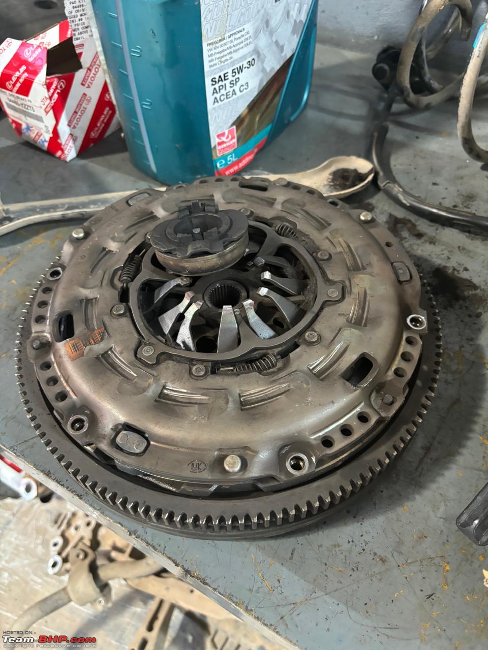

The clutch on my Skoda Laura has entirely failed. I have contacted Carmed Bangalore for a quote regarding the complete replacement of the clutch system and an overhaul of the front suspension. The estimate provided was quite similar to that of the skoda dealership. Nevertheless, I decided to proceed with their services due to their reputation for honesty and the transparency they offer regarding the repairs being conducted. I will share a detailed breakdown of the costs and my review once the car is returned in a few days.

The Skoda Laura Petrol TSI Ambition model is over 13 years old and currently has an odometer reading of more than 71,000 kilometers. Although I considered scrapping the vehicle in favor of a new one, personal circumstances led me to the decision to retain it for an additional 3 to 4 years. I began repairs on the ABS sensor on September 14th. The sensor has since been replaced, and the error light is now off.
After leaving the workshop and traveling only 200 meters, the clutch failed completely, necessitating that the car be towed back to the workshop. Given that both the clutch and front suspension had been weakening for the past 10,000 kilometers, I opted to fully replace the clutch system and overhaul the front suspension. This will be the first significant repair required for the vehicle in its 13-year history, aside from regular servicing and minor niggles
Included with this message are the pricing details and a few images.
I retrieved the car on September 30th after two weeks, and I've noticed it feels more stable on the road. The clutch has also become more precise, allowing me to confidently navigate steep inclines like parking ramps.
