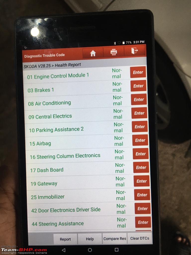

Couple of days back, while trying the start the car, it gave a long crank and then started but the engine died. I initially thought may be ignition coil or may be fuel. But after the car started and ran well for 2 hours, I let it pass as an one-off.
However, when the same thing repeated in the early morning start yesterday, I decided to take it to the ASC. The new Skoda service centre Mody Skoda at Kurla. The place was filled with cars and the SA informed me that there was a huge backlog due to Monsoon affected cars. I kinda agreed. This monsoon has been hard on my car too with lot of things squeaking due to the moisture.
The SA was since enough to get the car scanned and preliminary diagnose the problem but told me that no parts were available and it would take atleast a week to arrive. Given that I needed this car for the weekend travel, it was non negotiable. However given that this particular SA and me have formed a bond over 3 workshops and my 2 cars, he called up a specialist and referred me to him.
I went to this guy called Sameer Khan who calls himself as a specialist for VW and Skoda especially their electronics. I went to his workshop and a couple of Superbs, 3rd Gen Octy and couple of Laura.
He preliminary diagnosed the problem to be Fuel Pump but told me he will study the fuel flow readings and data and inform me what the issue post detailed diagnosis. I left the car at his place and came home.
Couple hours later, Sameer calls and says my fuel pump and the chip along with the pump were fine but the culprit was the High Pressure Pump before the Pressure Rail. He also tells me that the expenditure will be less than the previous estimate.
3:30PM today got a whatsapp with this:
Skoda Laura: Problems & solutions thread-whatsapp-image-20210812-15.30.16.jpeg
I had also asked for the following to be fixed which had stopped working / started behaving wonky due to the relentless monsoon this season:
  • Rear Parking Sensor not working
  • Driver door behaving wonky while trying to open from inside.
All were solved and I was presented with this bill.
Skoda Laura: Problems & solutions thread-laura-shahin-auto.jpg
Even though its too early, I liked Sameer's attitude towards work. Recommended!
MileCruncher is offline   (1) Thanks

Hi Guys,
My Laura 2.0 TDI (2011) is now again angry with me. Not starting...
I had parked the car at Hyderabad Airport on Friday evening and landed back on Sunday evening. The car started but suddenly all the lights in dashboard came on. Paid for the parking and came to arrival ramp to pick up by baggage and family. Loaded the car and the car wouldn't start. Sometimes the car cranked and started and died within 3 seconds. Sometimes there was only a click and sometimes it cranked and not start. Couple of times the Key got stuck in the key hole and wouldn't come out.
Many drivers around tried to help and also tried to Jump start with other vehicle but to no avail. Also since its DSG they gave up on trying to push start.
Called 24/7 Road Assistance of Bajaj Alliance but could not reach them as it was already 9.00 in the night. (so much for 24/7). Parked the car in a acquaintance's parking slot near airport by pulling my car.
On Monday could reach the 24/7 road side assistance and a towing truck was sent within one hour to pick up my car. Sent the car to Sanathnagar Service center.
Went to service center today and met Pratap who is in charge of workshop and he explained that water has gone into the circuit and the electronics has to be checked. Was very helpful in explaining the faults. Will come to now of the damage only by today evening.
Has anyone faced this in Laura?
Any other suggestions is appreciated.
Thanks
