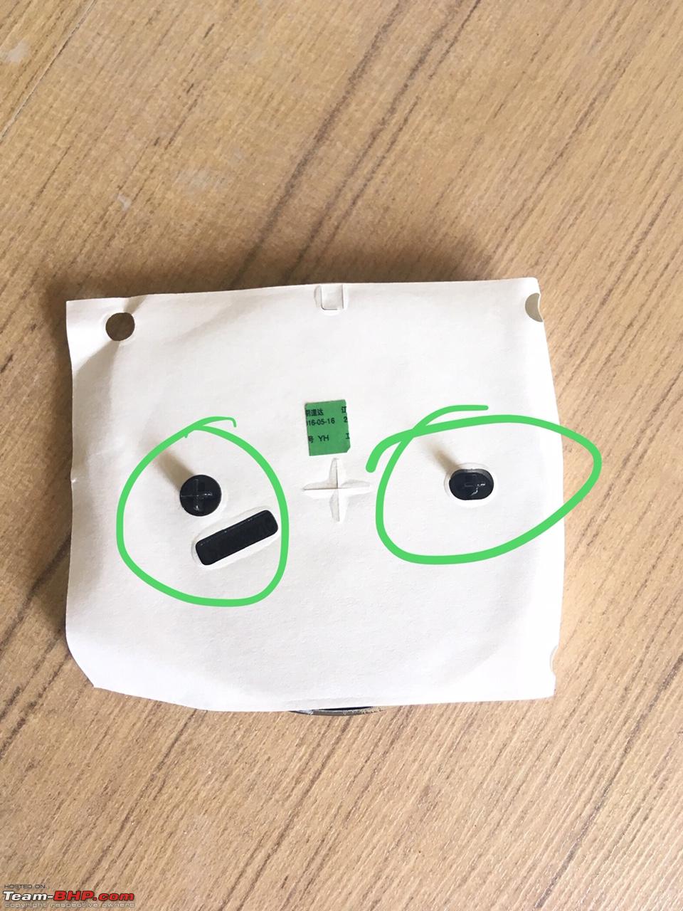

Originally Posted by nerd1200 View Post
Guys, Question for anyone who got the New Skoda emblems on the Laura - what is the size of the front and rear emblems? Also, any idea if I can get it fitted anywhere in Bangalore?
I reached out to ASS and an FNG, they said that it cannot be done since the pins were different for the old and new ones.
Hi Nerd1200,
Yes, new emblems can be easily fixed on Laura. I've got the same fixed on my ride. Newer logos has pins at the rear, which is easily removable. Post removal of said pins, use aradlite or equivalent adhesive to paste the sticker at designated place.
Logo size is 90MM(front) & 80MM(rear). Some pictures for your ready reference, I ordered them from Aliexpress

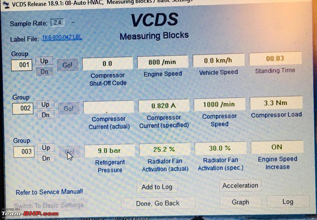

Thanks to Deb, we could try out his VCDS in my friend's Laura . Based on the experience now he has purchased his own VCDS cable & software.
Below is the reading we observe, while scanning HVAC module when the AC is not working. The compressor current (actual) doesn't show any value. What could be the reason for it?
You would need to check the fuses and relays as a start. Was under the impression that the AC compressor was purely mechanical. It might also point to the fact that the electromechanical clutch might have failed. That costs under 10k
