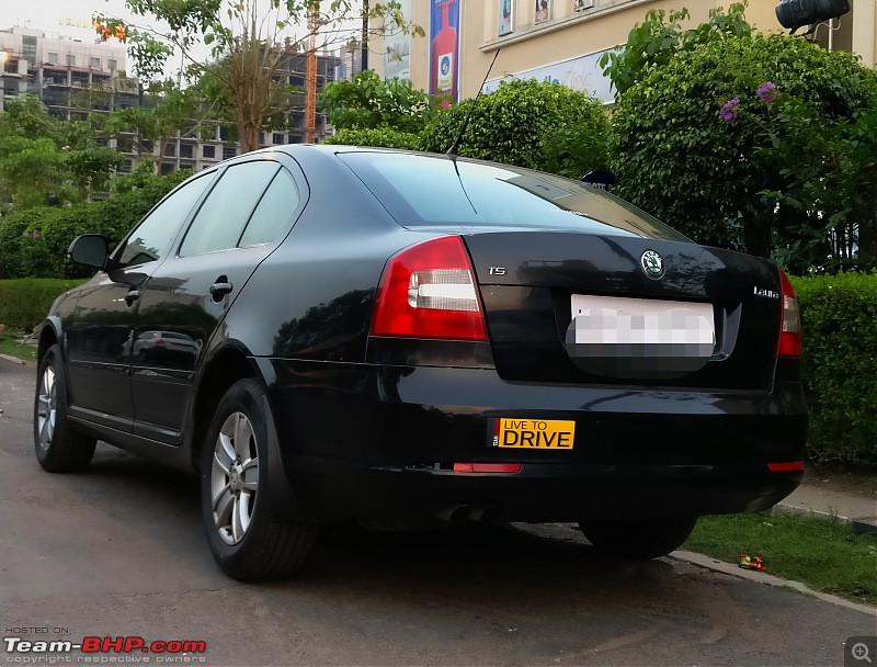

Here are a couple of pics of the car. There are a few issues which requires to be sorted however overall it is blast to drive. It will be going on a 2k km trip next week. Let's see what's in store. Fingers crossed
